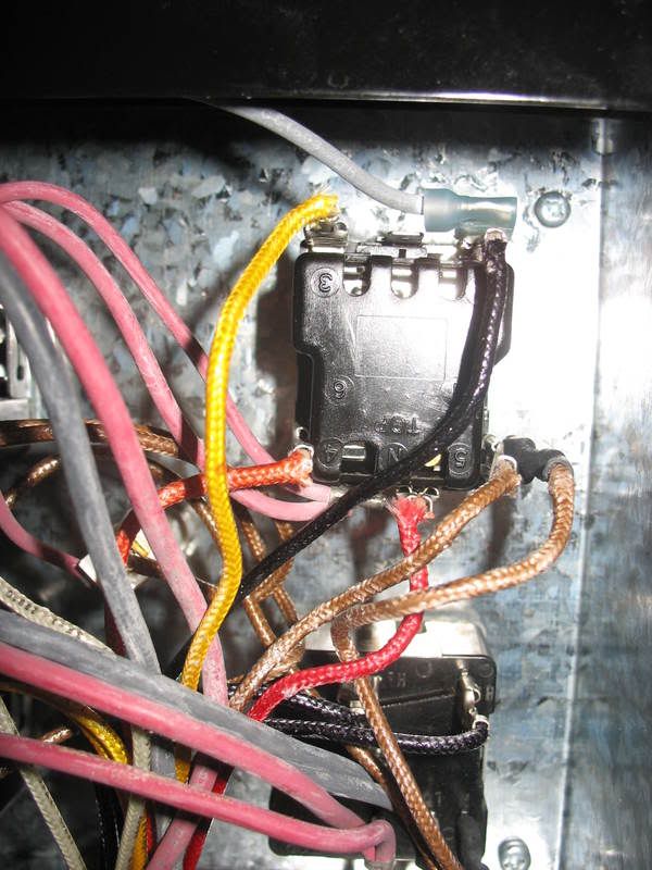

Just a note and Gene can correct me here. The wiring instructions on the APP part AP3775555 were sufficient but what I did notice was that ON THE OLD BLACK SWITCH (see picture below) is that there are TWO sets of wires that go to the “N” connection. The PINK wires and the RED wire.
The confusing part is: Is that on the replacement switch you have an (L2) connection with one pin and an (L2B) connection with two pins to connect wires too.
Option 1: On the new switch I was not sure if to place the PINK and RED wires side by side on the (L2B) connection.
OR
Option 2: Place the pink wire on the (L2) connection and the red on the (L2B) connection or vice a versa but they would not be side by side as they were on the old switch (N) connection.
I reasoned with common sense and went with option 1 and placed them side by side on the (L2B) pins since I figured that they were together on the old (N) connection and not separate. After a prayer I turned it on and it worked just fine.
All the other wires are clear cut based on the wiring instructions that come with the part. What would of helped on the new wiring instructions is something that notes something like (L2) = DO NOT CONNECT WIRE HERE as there are a couple of pins that stay free when you are done.
If I get a chance I will go back under tonight and post a picture of the new part and how the wires were connected.
Once last comment after installing the part I can see now, when you are CLEANING the glass top surface with the knobs taken off and with the special creams made for cleaning them, windex or just plain old soap and water, if YOUR NOT CAREFUL, these liquids can make their way down onto the top of the switch and damage them.
I wish that the rubber bushing that goes below the knob had a tighter gap around neck of the switch itself to keep liquids and debree out.
If you are a a very clean individual, and go happy with the liquids, then just be careful. My wife removes the knobs to clean the glass top and she is not happy until she gets a mirror shine on the glass top. At $150+ a part I will need to stay on top of this. :cool:

I manage to take the pictures of the new switch not easy getting a clean shot.
Notice the following
Red and Pink wires are on the (L2B) connection TOGETHER
BLACK & Grey Wire = (L1)
YELLOW = (H1)
ORANGE = (H2)
BROWN Wires (2) of them = (P)
Pin (L2) is NOT USED
Pin between (L2) and (L1) no label, is not used
Pin between (L2b) and (H1) no label, is not used
This part was used to repair an FRIGIDAIRE FEC3026HSA / Electric Cooktop and may not represent the wiring for another cooktop.
Good luck

The exact same part was used to replace a Sears #903057-9010 part number, used your diagram and photos on a FRIGIDAIRE FEC30S6HBA. Great job, this is what the internet was invented for not all the other B.S. :smiley:
I work in technology myself and a picture and diagram paints 1K words. Glad it could help. :slight_smile:
