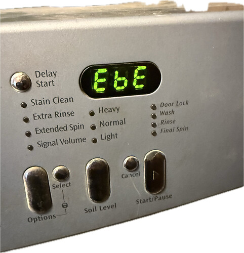

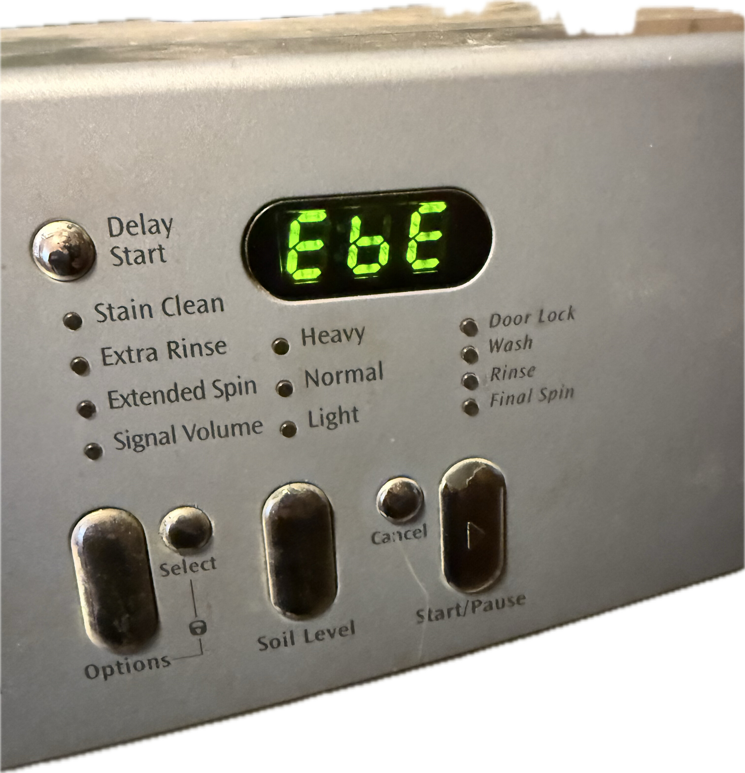

Frigidaire affinity will not run wash cycle
Brand:Frigidaire Frigidaire
Model Number:ATF8000FG0
Main Symptom:won’t start all the lights light up
What happens & when:when selecting wash cycle and push select/start button door locks then all function lights light up, and the washer does nothing
Error Code (if any):E6E or EbE
Parts or tests already tried:replaced door lock switch
Photos / video
link:
This error code EBE is a console control problem in which case the control board would need to be replaced.
https://www.appliancepartspros.com/frigidaire-control-board-137007000nh-ap7185433.html
