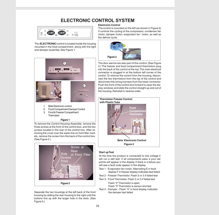

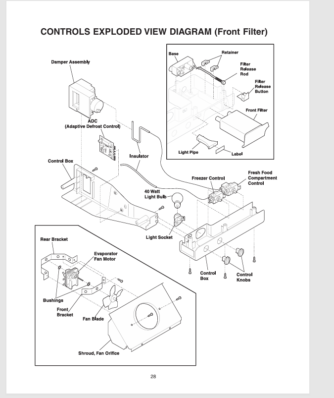

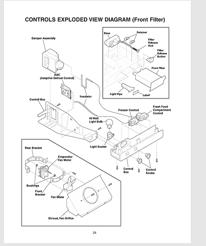

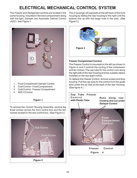

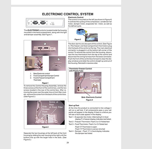

Hi, here’s a diagram showing all of the sensors and their locations. This should help you identify which sensors you need to check and where they are located on the unit. Hope this helps!
