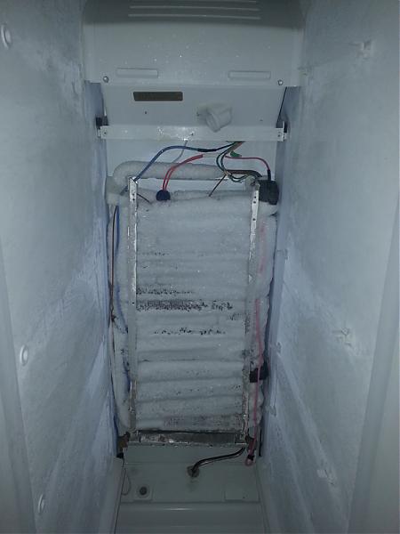

3 weeks ago I woke up to a puddle of water and warm fridge. Freezer froze up and wouldnt keep cold. Freezer was at about 40 degrees. Removed everything and unplugged the unit. We were just leaving for 5 days so I left it unplugged and plugged it back in when we got home.
Worked fine. Freezer around 3 and fridge around 34 degrees. Last Saturday, fridge was back up to 58 and freezer was up to 25 degrees. Opened the back panel and it was all frozen up again.
Unplugged it and let it defrost. From everything I read, it seemed like the defrost thermostat was bad. Ordered one Monday morning from here and just replaced it. Plugged the fridge back in and the lights turn on, but nothing else. No cold air or even sounding like it is going to turn on.

you make sure you put the defrost timer in correctly and installed it with it unplugged…check that area you worked in and make sure you didn’t pull off any other wires to anything else
Doubled, even tripled checked other wires in there. I thought the same thing at first since I didnt have that much room to work in there. Broad shoulders. Watched the video for the installation a couple of times before installing it.
