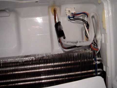

Fridge not cooling. No frost on coils.
Fridge is cooling, but only a little, not enough. Freezer foods are thawing.
I took out the evaporator cover and there was some ice on the wires, which I removed, but none on the coils.
Not sure if my model is frost-less, I can’t find any information about it on the internet.
I don’t know where the defrost timer is to test it and see if it clicks.
Where do I go from here?
Thank you.
Is the condenser fan running? Its the fan in the back, underneath the fridge.
Do your coils look like this?
That is what happens when your fridge has lost most of its freon.

Yes, the condenser fan is working.
The coils do look like that.
Initially when I took off the cover, the evaporator fan wasn’t working well (like a broken/stuck clock hand going back and forth). I spinned it manually and unplugged it, plugged it back in and it started working again. Frost seems to be coming back now. I’m not sure if that fixed it.
Only the top coils have frost now 24 hours later. I caught the fan not working again, but it was working this morning. I’m not sure if it’s just the fan or more things wrong with it. Should I try adding WD-40?
If you had enough freon, all of the coils would have a light coating of frost.
When your sealed system is low on freon, there is not enough freon to frost the coils completely and you loose a % of your cooling capacity.
The picture I posted has lost about 97% of its cooling capacity. Yours sounds like its lost 80% or more of its cooling ability. The fan motor not running just makes it worse.
You probably have a leak or leaks that has allowed your freon to leave the sealed system. Finding and repairing the leaks and refilling the system, which is time consuming and can be expensive, is about the only way to fix this.
