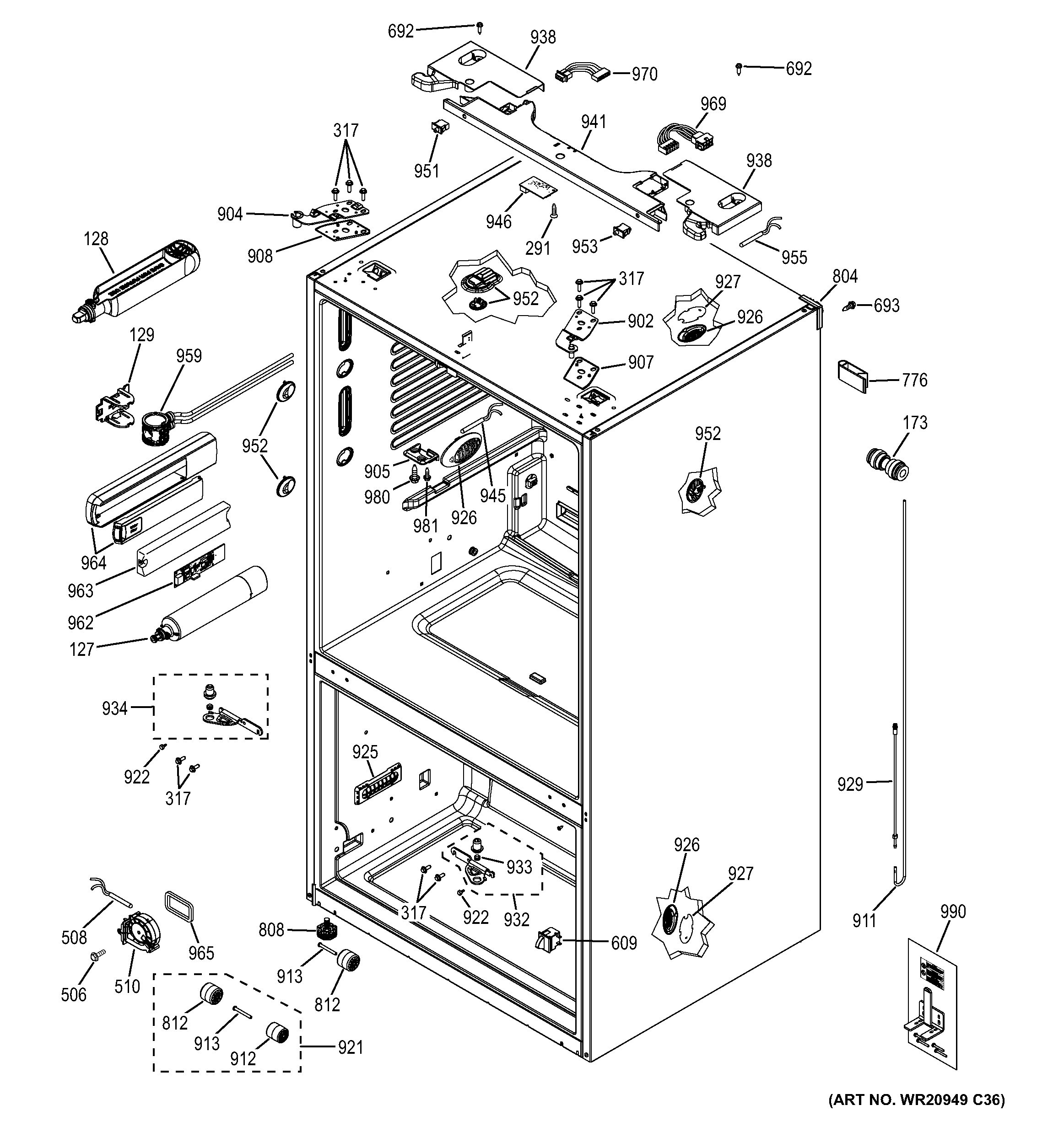

I have a GE Cafe fridge-over-freezer where the fresh food section is not getting cold - it’s holding steady at about 55 degrees F (it’s set to 34). The freezer is 0 degrees F, the meat drawer is around 34 degrees (it’s set to 32), and the ice maker in the door still makes/holds ice fine.
This unit has separate evaporator coils for the freezer and fridge sections (there is no damper/fan to pull air from the freezer to the fridge section). The main FF section and meat drawer both cool from the fridge evaporator, each with their own fan. The freezer evaporator coil chills the freezer and ice maker in the door.

Chassis Diagram
Fridge Section Diagram

Since the meat drawer stays at the correct temperature, I’m thinking the evaporator coil and evaporator thermistor are likely working properly. My main questions are:
  1. Why doesn’t the FF section fan turn on when the FF section is 55 degrees?
  2. When the FF section fan does run, why does it blow 40 degree air?
  3. Why does the digital display say the fridge temp is 40 degrees, even though the 3 thermistors are all significantly warmer than that?
