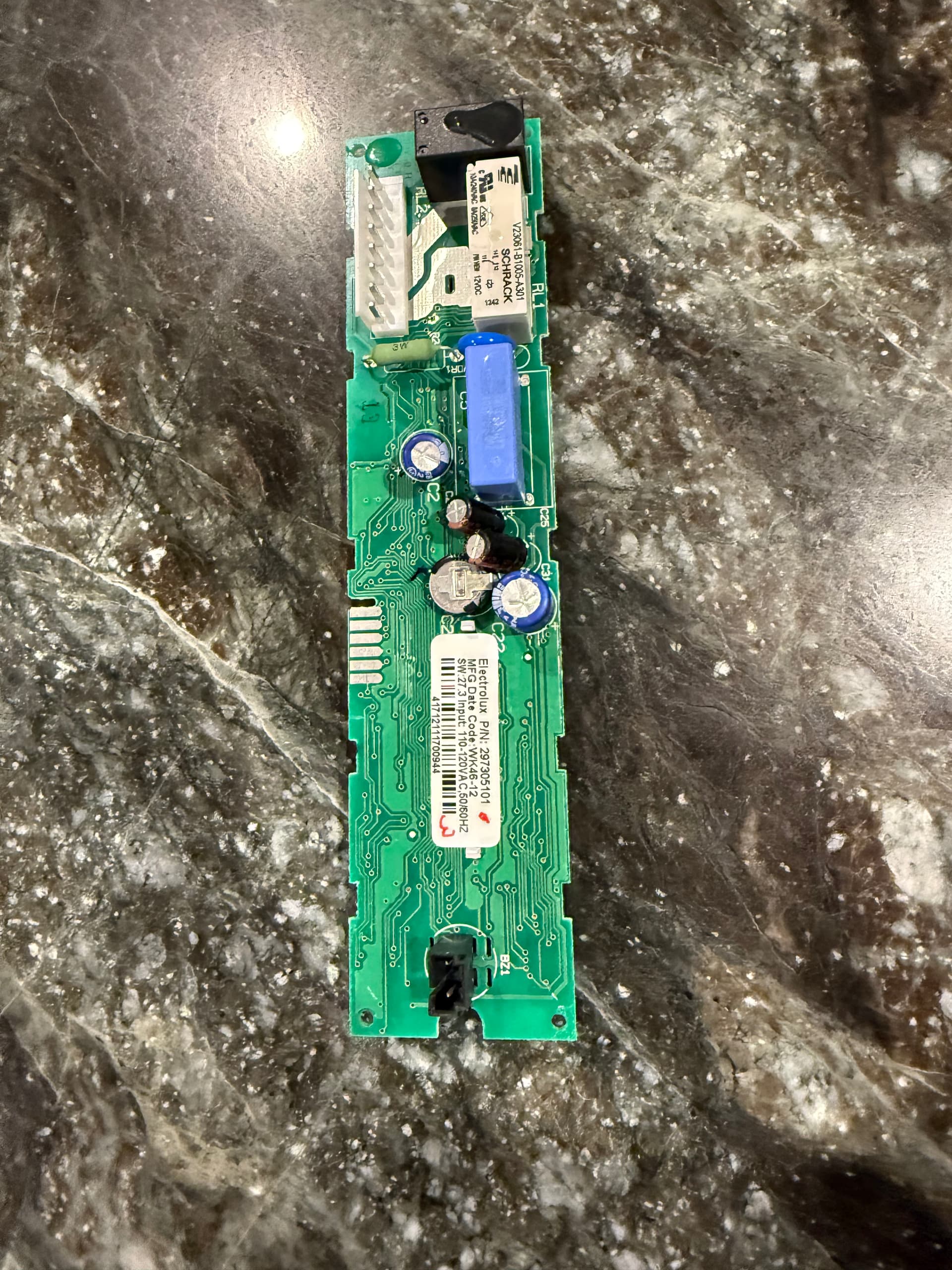

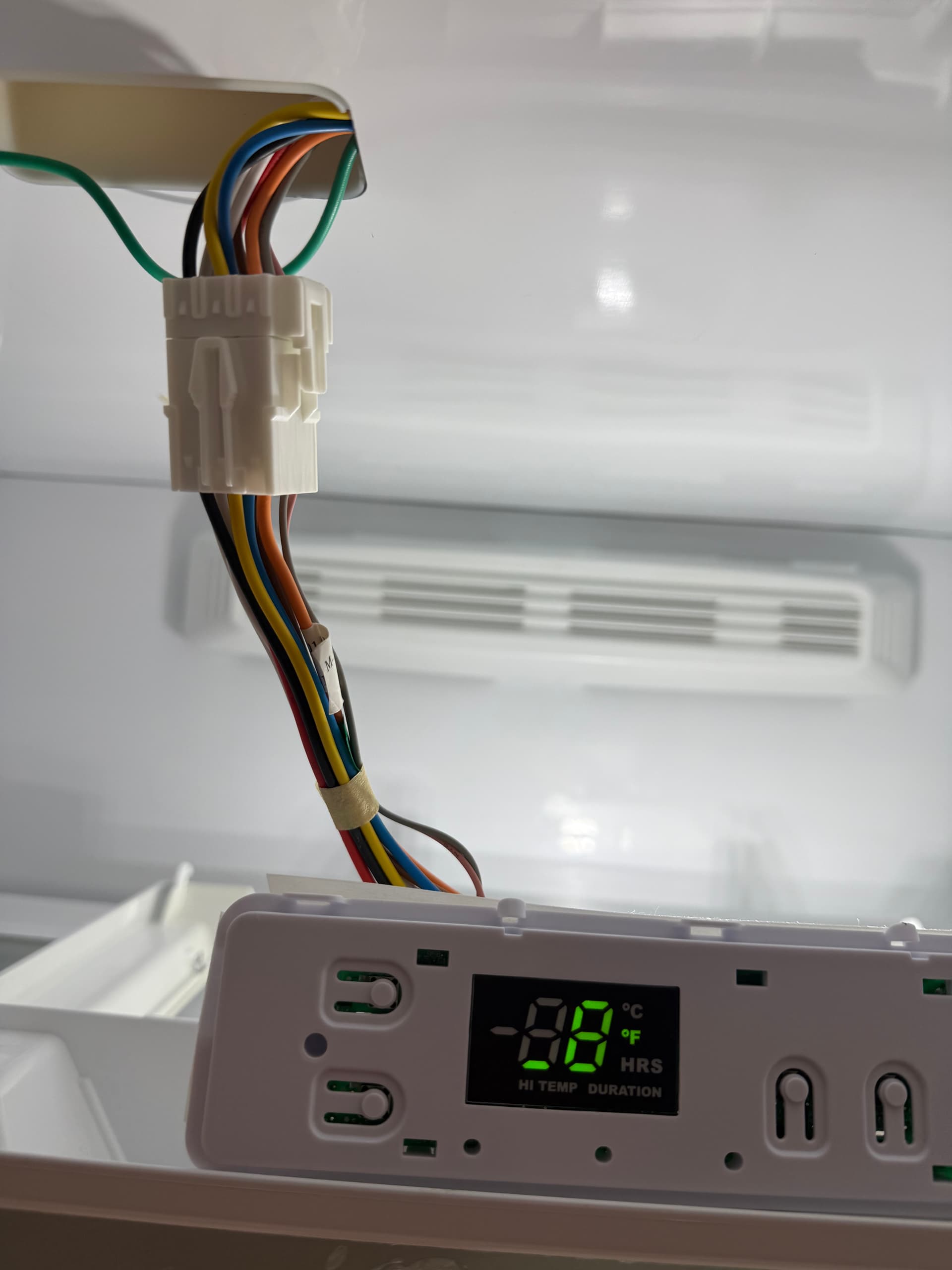

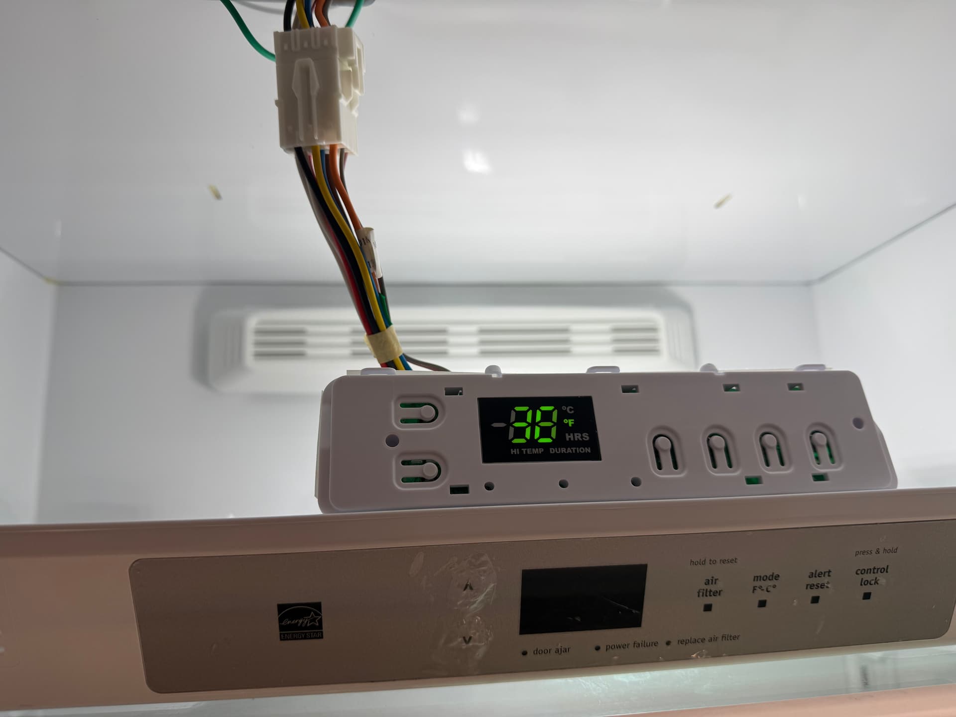

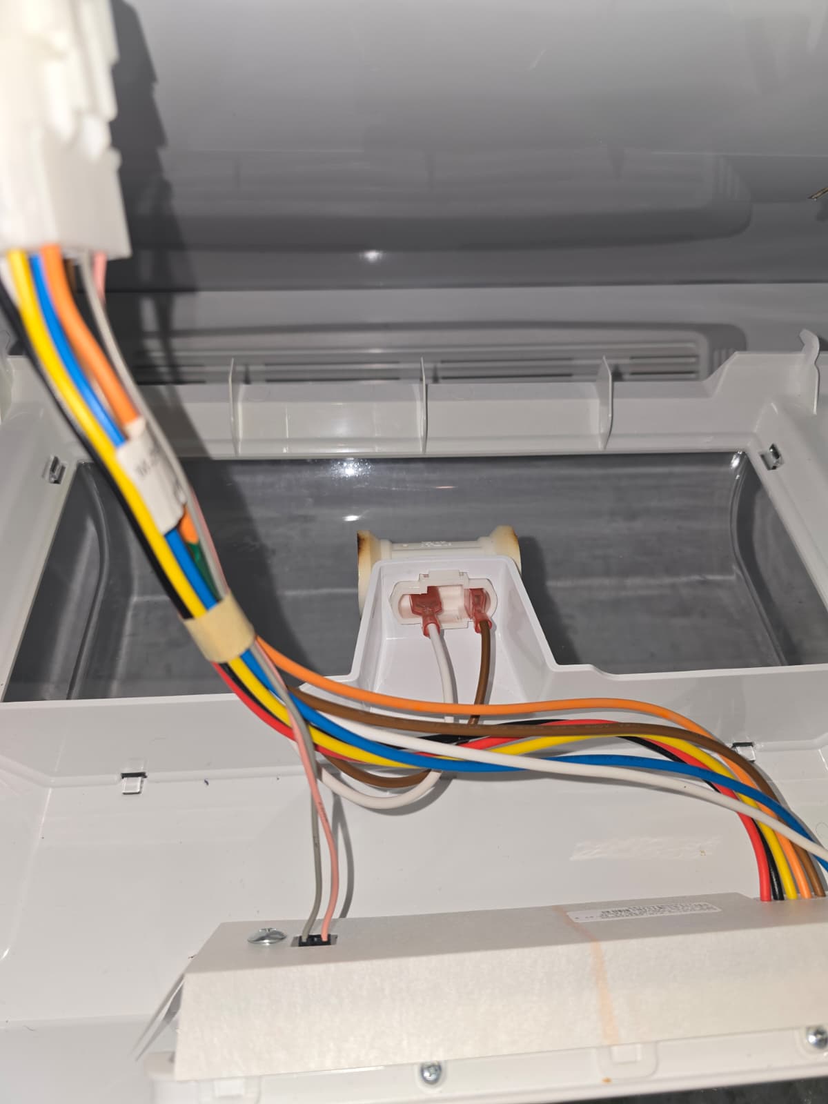

Everything is orignal except for the control board and the thermister. I’m attaching a picture o the board, i installed it into the original “cabinet” that houses the board, and i plugged it into the original cables that came with the fridge also pictured.
What you are suggesting makes sense since five boards didnt work, and one is on and off. any advise on how i can fix that?
For testing purposes, what happens if the LED lights are removed? Also, it appears there is a slight gap in the wire connection near the ceiling. Is there any room for it to push in more?

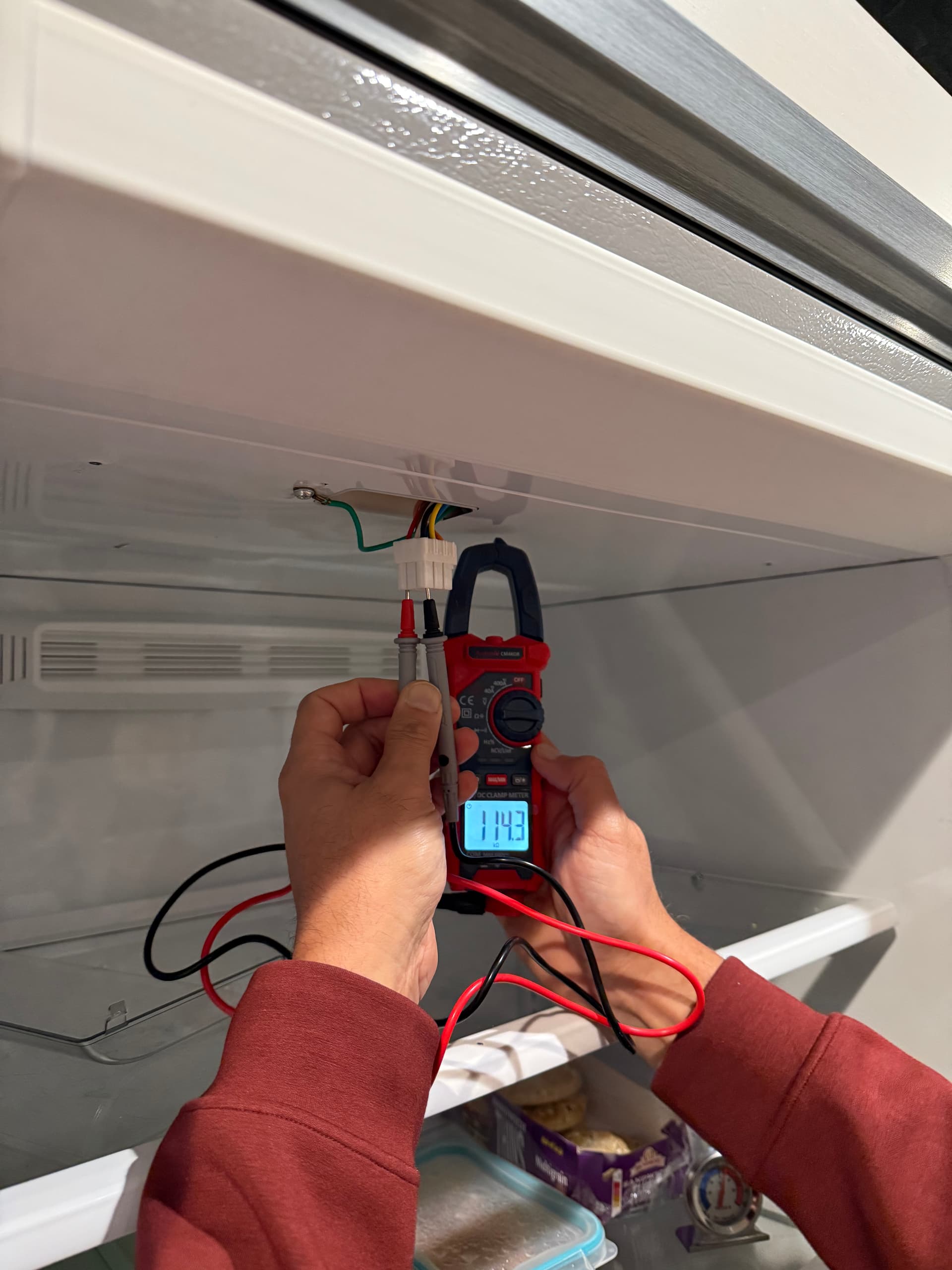

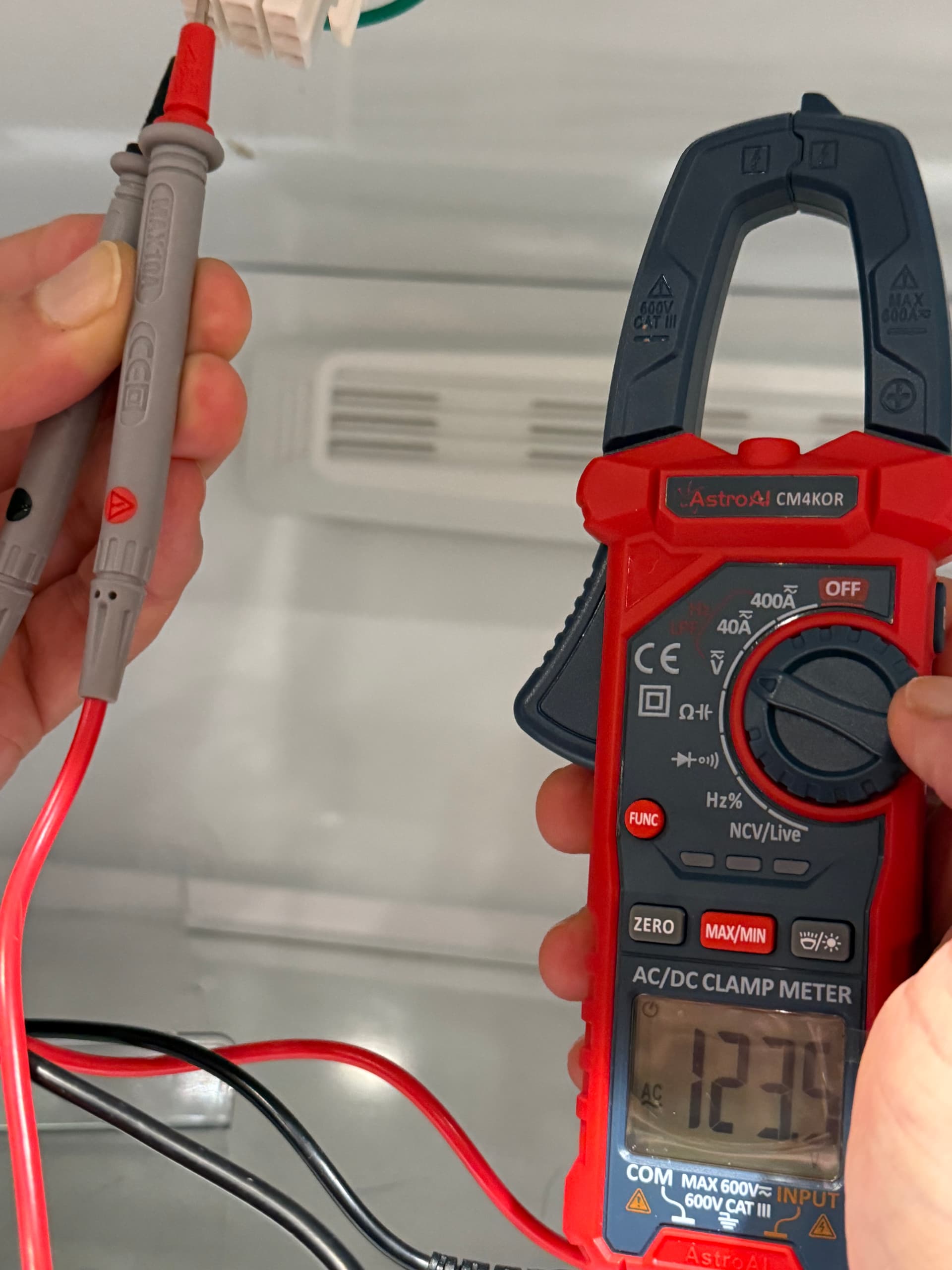

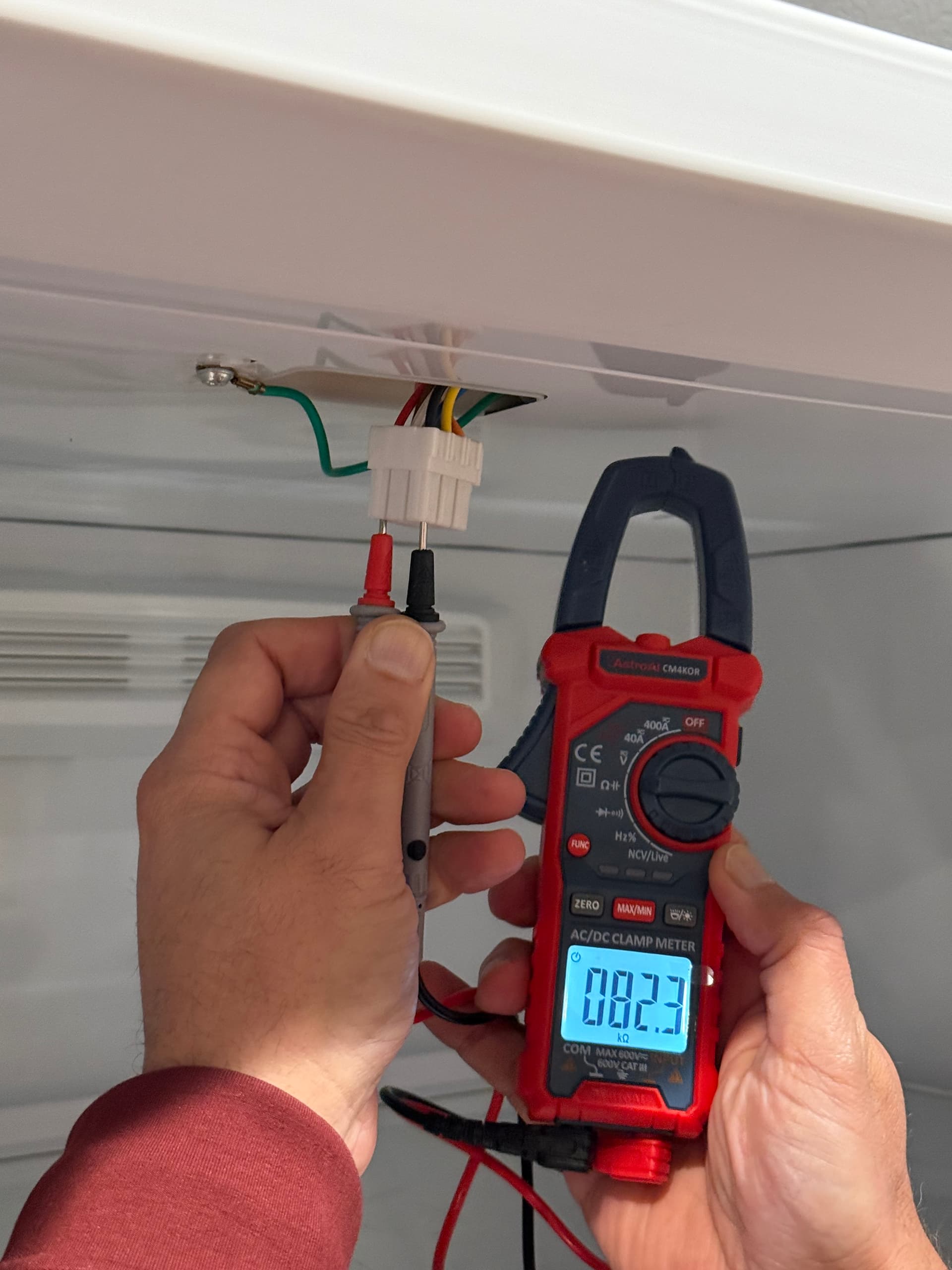

If you would not mind, would you be able to test from the black wire to the white wire for Volts AC with a multimeter? What voltage reading shows up? Once that is identified, if the power supply cord could be unplugged, the 7-wire connection at the main control disconnected, and the red wire tested for resistance to the black wire. What resistance reading shows up?
the first pic-white to black voltage is 123. 5 AC V
after unplugging the fridge (removing power from circuit breaker), Red to black resistance, is 82.3 K ohms
Picture 3 red to black resistance with power CONNECTED, 114.3 K Ohms.

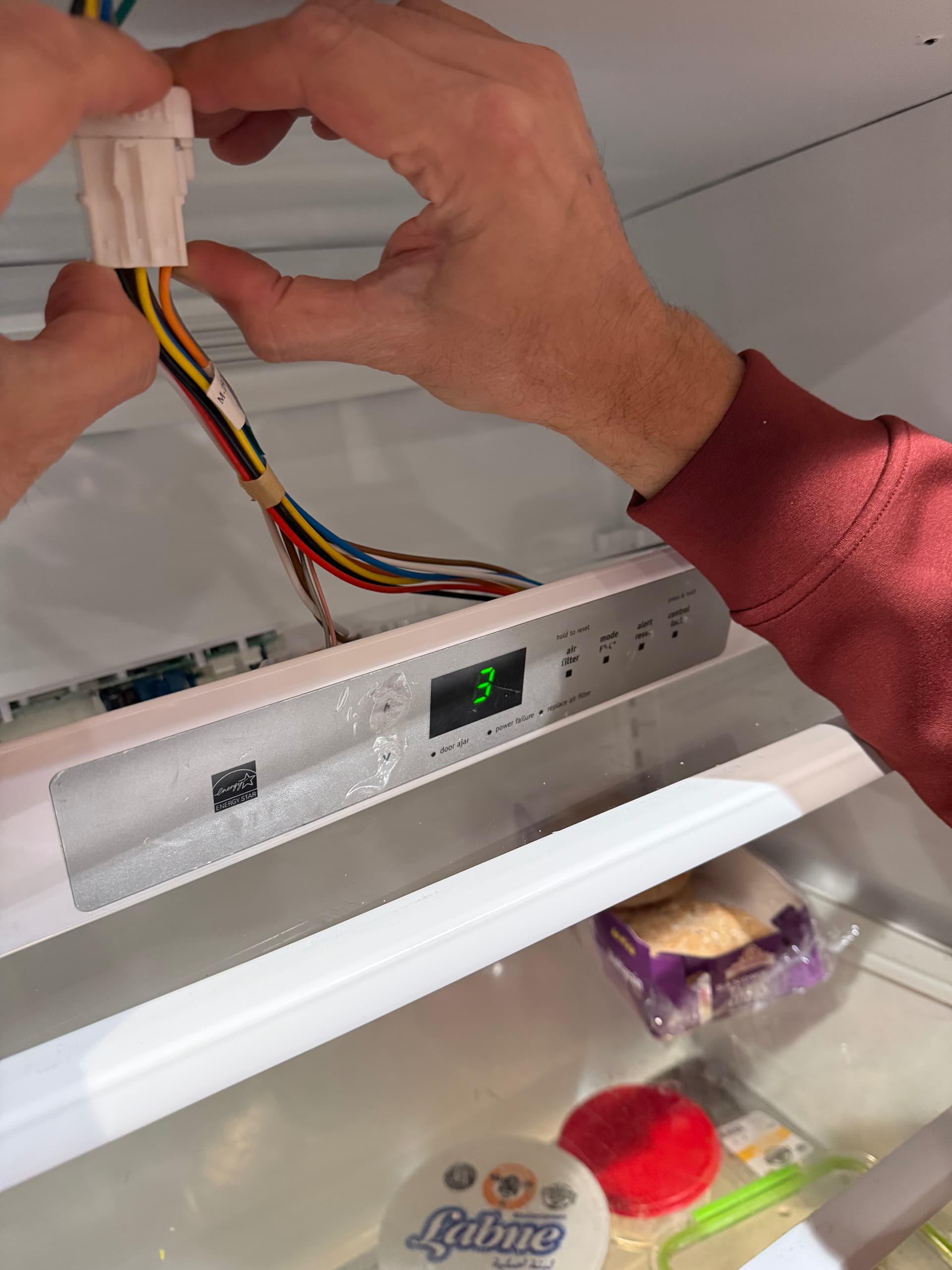

The thermistor circuit appears to be good and the voltage is certainly good. Using the control that had the working LEDs but was freezing everything, there should be a model ID displayed for 5 seconds when you first plug the power cord in. What model number does it display?
There is no model number that shows up, i’ve seen those installed multiple times the only thing that shows up is the number 3. Attached is the picture.

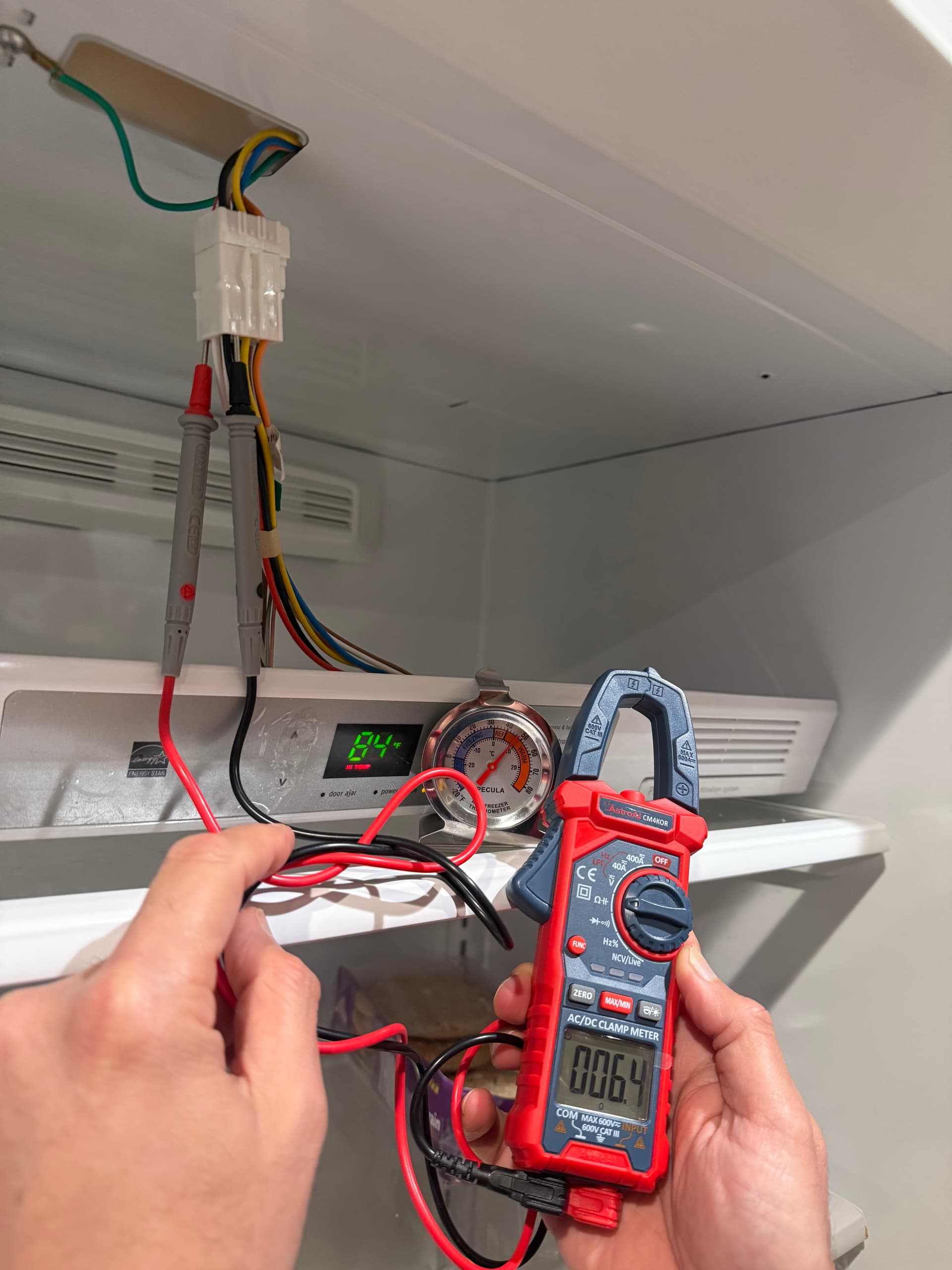

we plugged in the part, compressor started, temperature reading in fridge (on control board says high temperature-83), but its really like 55. Fridge kept cooling it reached 42, but fridge kept going, and so we measured the ohms- heres a picture. Does that make any sense?

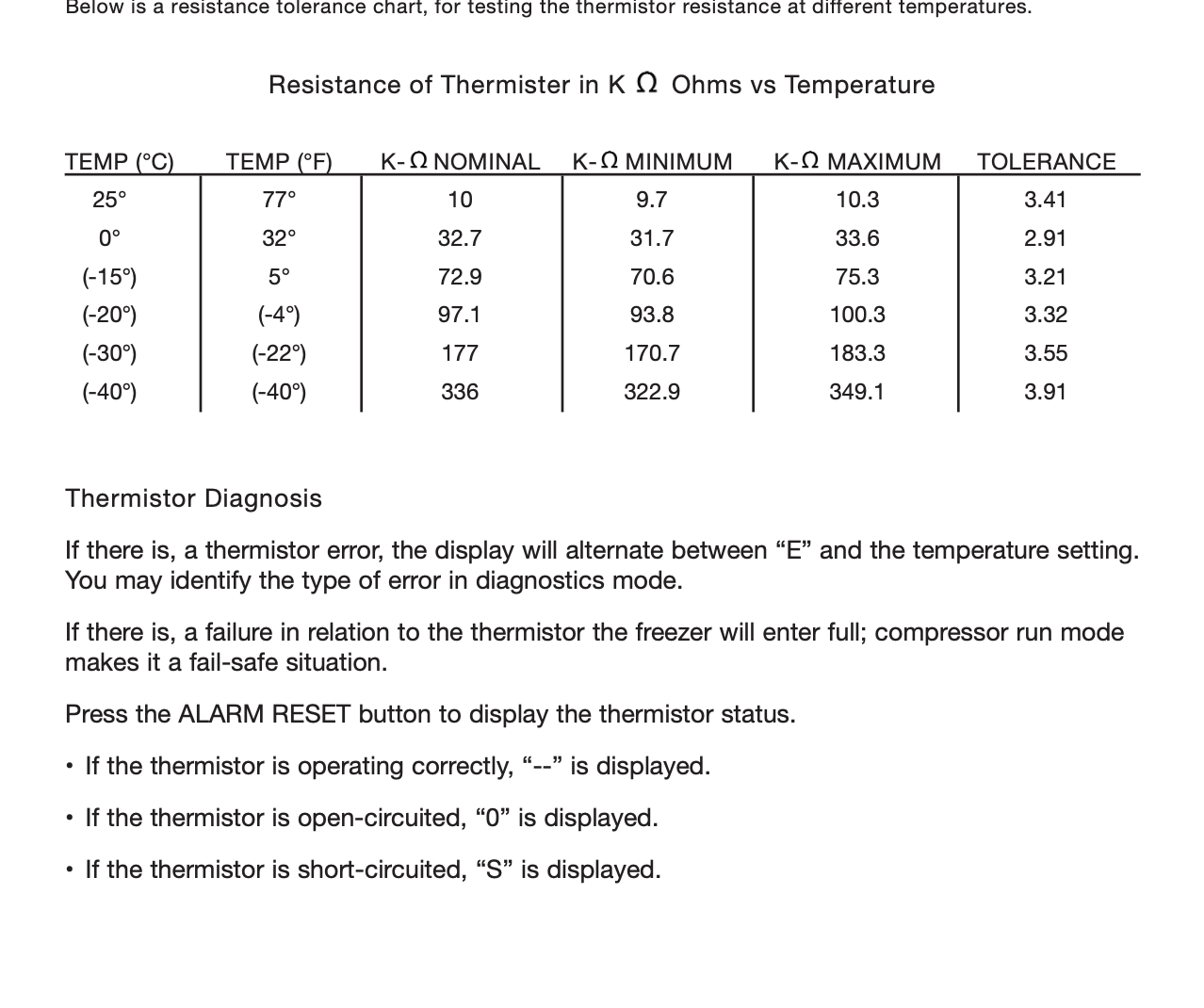

See if any of this is helpful. http://www.uncleharrywizard.com/nephewclub/wizardfrig/electrolux-frigidaire/5995573499-19cuft-all-refri.pdf
297367100.pdf (364.2 KB)
297110400 Thermistor.pdf (29.5 KB)
Thank you for sharing the docs. Upon looking at the termistor document, here is what we found.

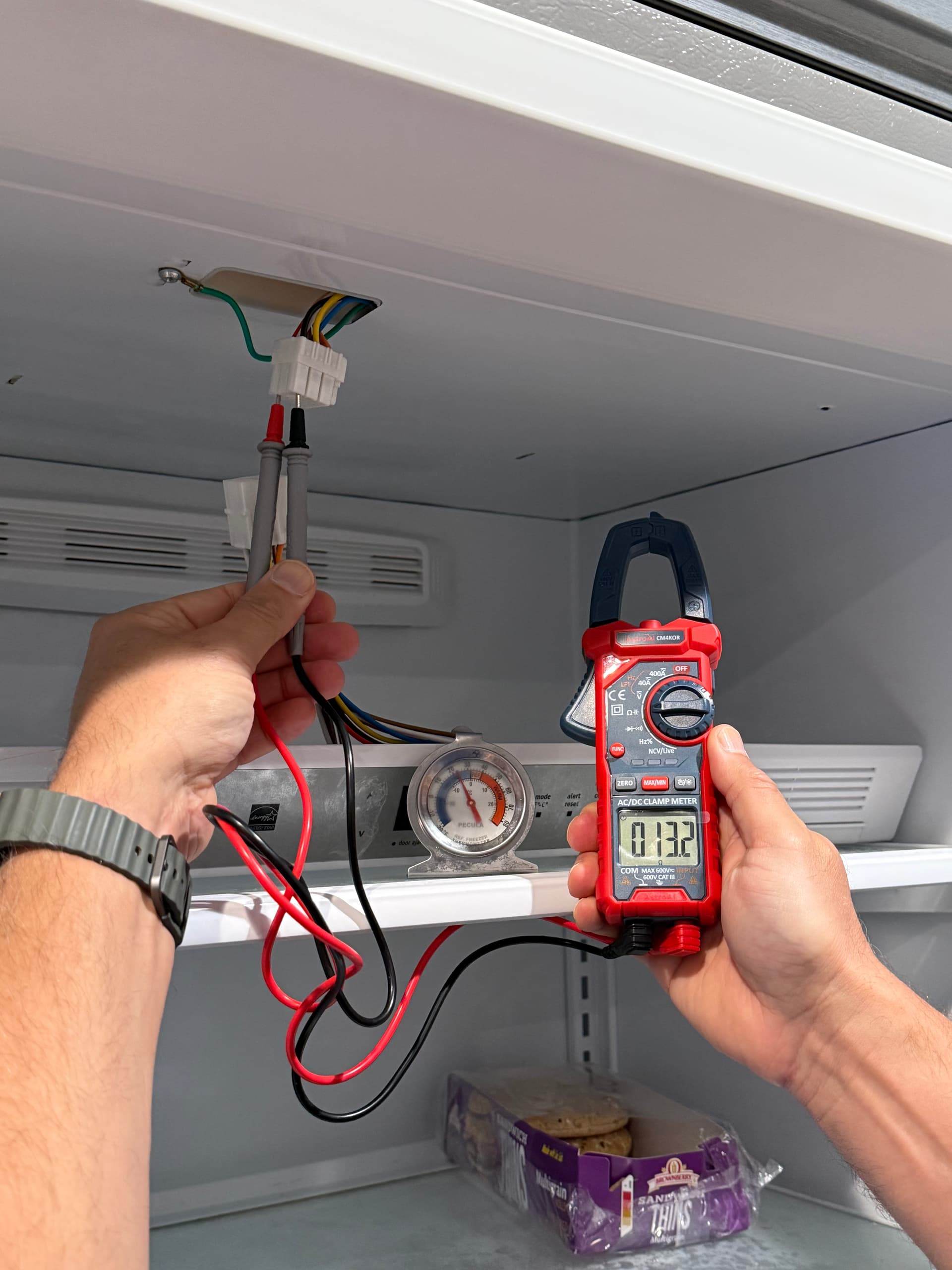

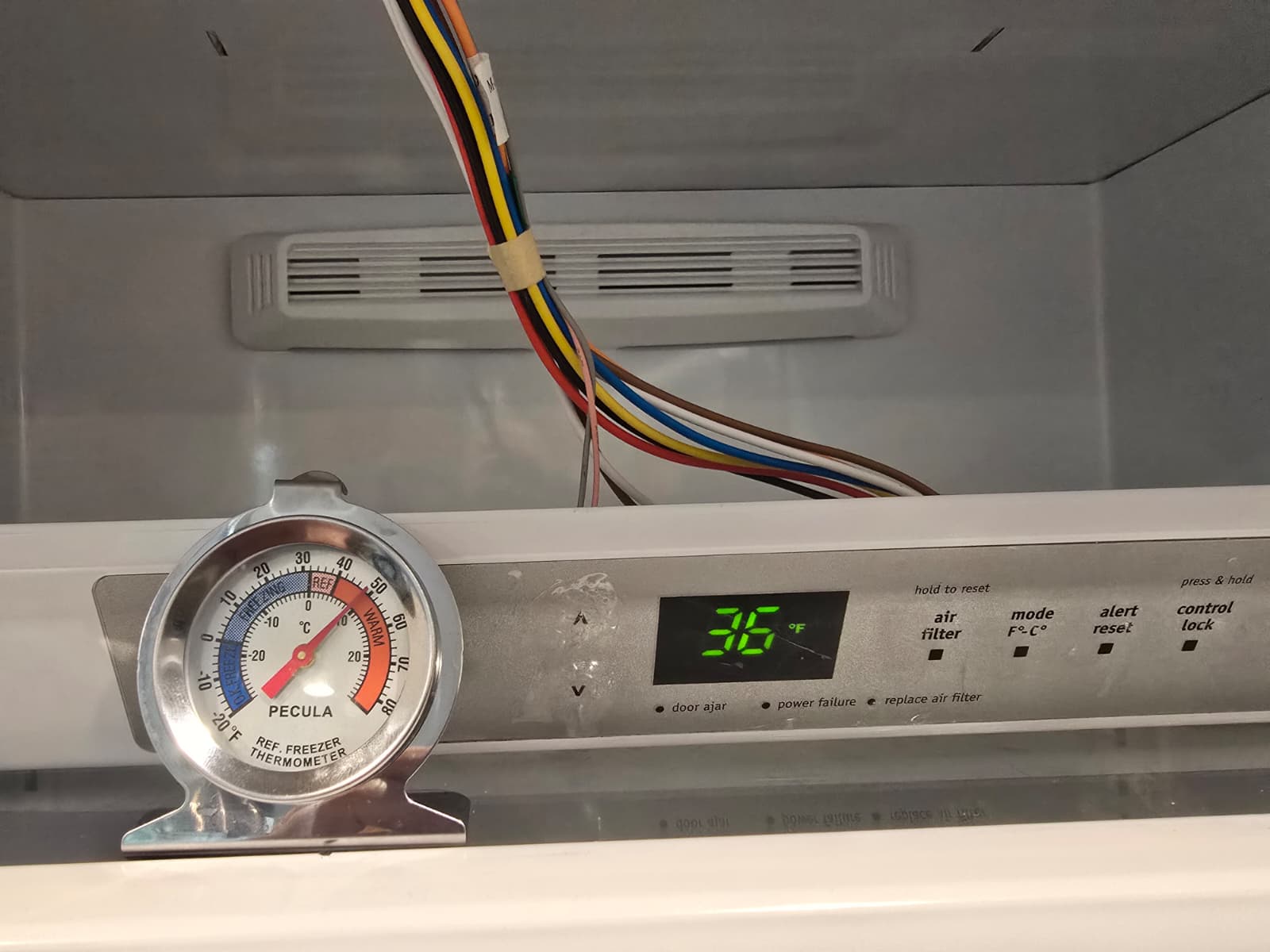

Our fridge froze overnight, so it didn’t stop after reaching the desired temp. we measured the resistance with the temperature displayed in the pic-around 24 degrees. that does not line up with the what the attached thermister document states.
When testing the thermistor resistance, the wire connection going to the control board would need to be disconnected. With the control side being connected, there could be a false reading.
Then this reading is done correctly as it is not connected to the board.

If I am reading the measurement correctly, it looks like it is 13.2 Ohms instead of K-Ohms. This would indicate an issue with the thermistor since 13.2 Ohms are going to read a significantly higher temperature than the refrigerator could safely be at. 297110400 Thermistor | Genuine Frigidaire OEM In Stock
Okay, the mystery continues. We bought from appliance pro a new thermister. We checked the oms of the old thermister (which was technically new since it was replaced by my appliance repair man), and it was giving wrong readings. like 10 ohm or so. We installed the newly bought thermister, measured the oms, and it read 10.2 Kohms which is in line with the chart above. Temperature was around 70 or so degrees in the fridge since it was off for a long time.
I proceeded to add the latest board from you guys, and as soon as I plugged in, the compressor kicked in normally, but the board was reading 83 degrees (high temp) in red. Kept the fridge running for 2-3 hrs, it reached 32 and i knew then that it was going to go to freezing, because the board kept saying 83 degrees, high temp and that signals that the compressor should keep going. I unplugged the control board, read the ohms at approx 34 degrees, and it was around 37 Khoms, which is in line with the chart, so I know my thermister is working. Could the control board be shot? what else would make the board still give me high temp reading considering the fridge temperature is almost at freezing?

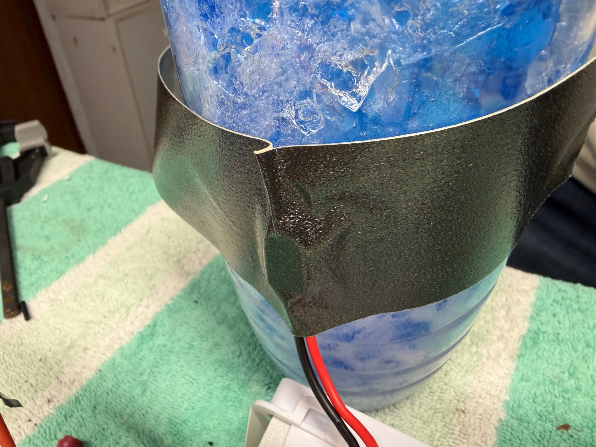

Stay with me here folks… I might be onto something…

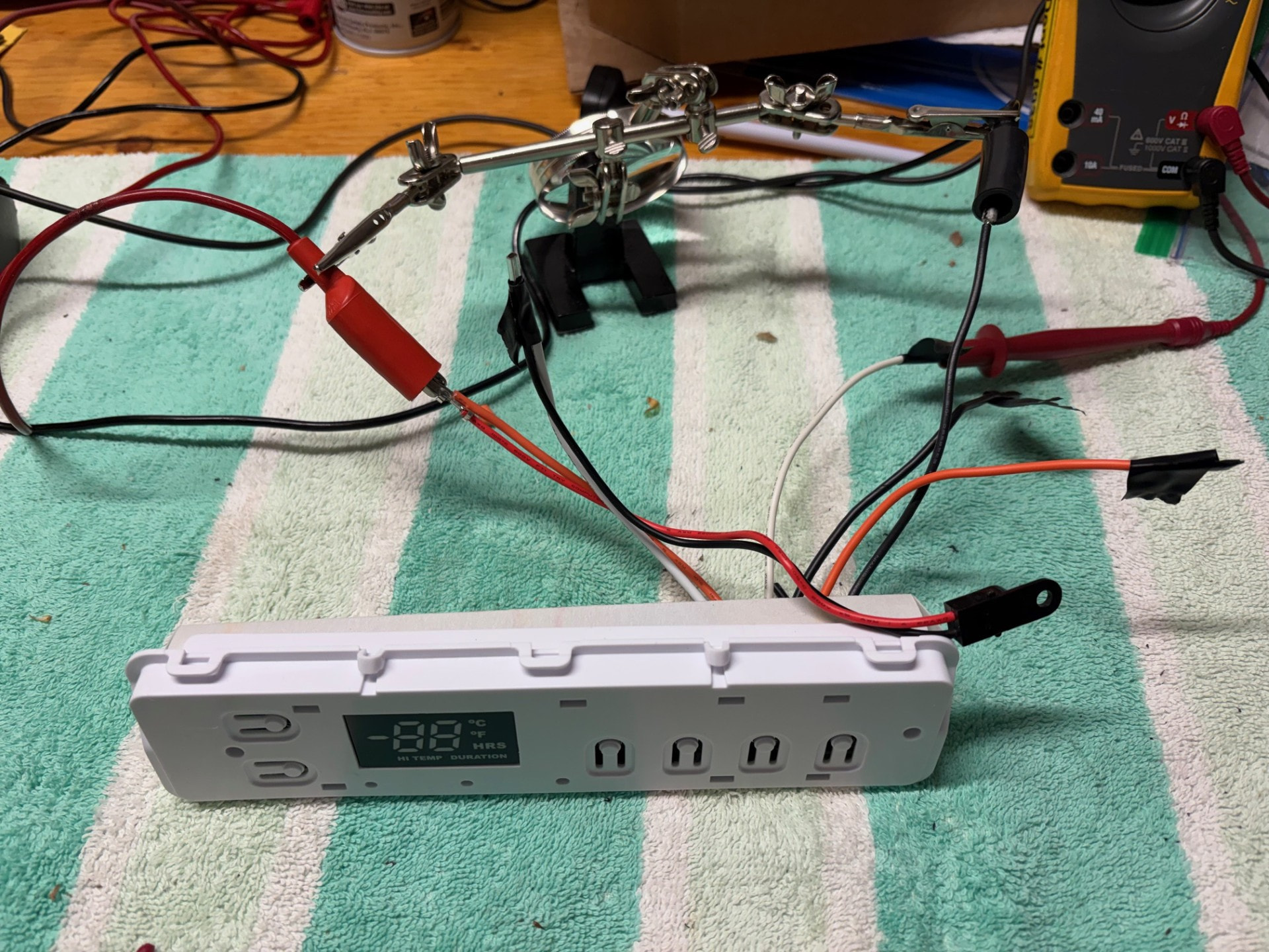

I did some more troubleshooting and went the extra mile.

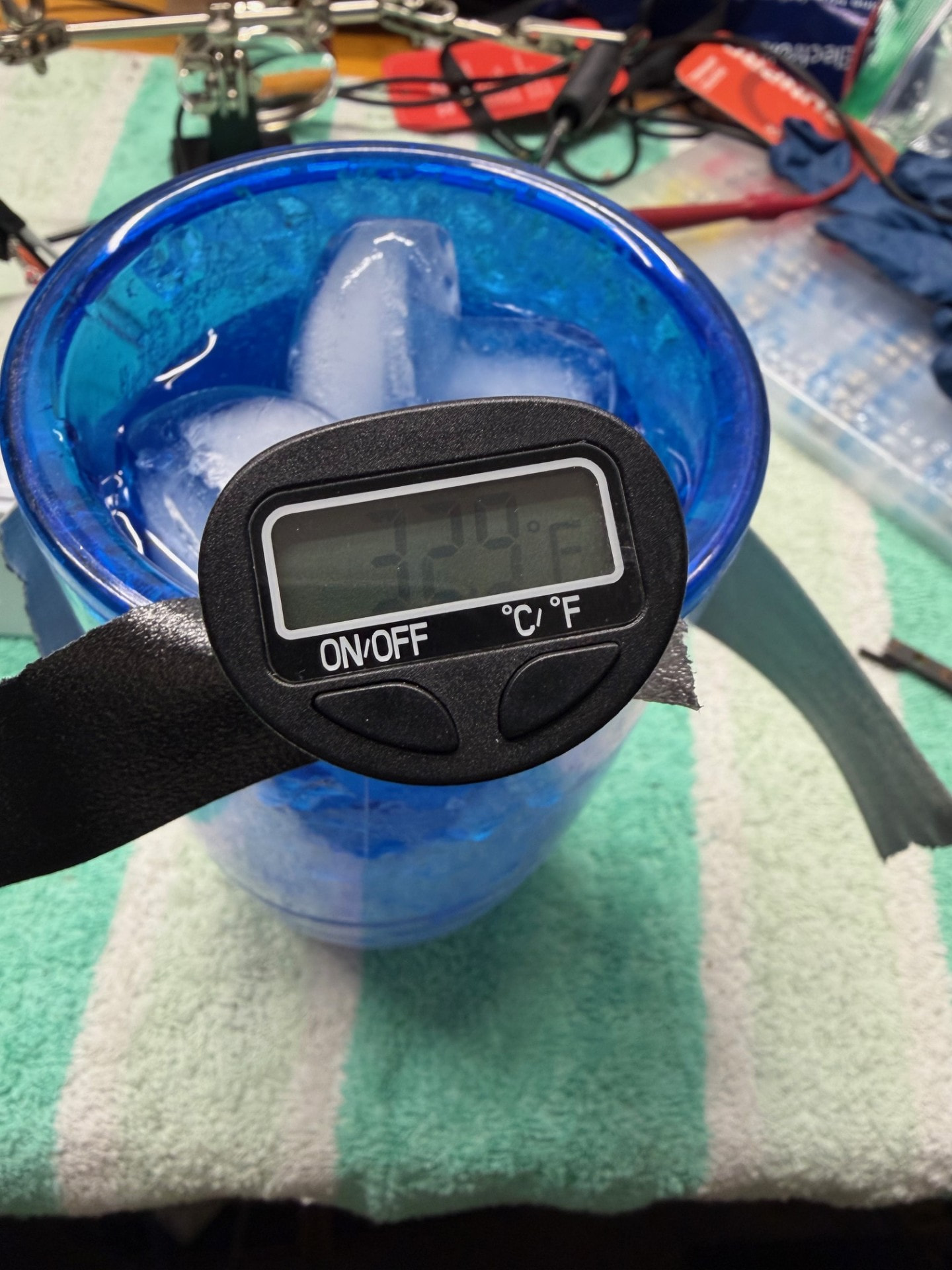

I powered up my old board on a test bench and stuck a known good thermistor on the side of an iced plastic cup. The thermistor was connected to the board as described on the diagram. The temperature on the inside of the cup was 32.5 degrees, and I measured the thermistor resistance it was 26K, that equals 32 degrees.
The output pin to the compressor was being monitored by a voltmeter.
Now that I know the resistance and the temperatures, I did the following:
Set the temp setpoint to 42 degrees and powered off the control board (CB).
Remember, my temperature on the plastic cub is approximately 32 degrees +/–0.5 degrees.
Set CB temp to 42 and the compressor off (voltage output from the CB was 0 volts)
Set CB temp to 41 and the compressor off (voltage output from the CB was 0 volts)
Set CB temp to 40 and the compressor off (voltage output from the CB was 0 volts)
Set CB temp to 39 and the compressor off (voltage output from the CB was 0 volts)
Set CB temp to 38 and the compressor on (voltage output from the CB was 110 volts)
At this point, I tried to increase the temperature back up to 42, but the output to the compressor wire was still showing 110v.
This pretty much proves that my old control board is bad unless you think otherwise.
My new control board behaves the same way. I think Frigidaire is selling defective control boards with tolerances that are out of spec.
Your thoughts….
