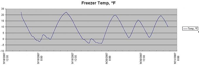

Hi all,
I’ve had quite an adventure tracking this problem down… and I think I’m close but need a little advice to finalize the issue.
I’ve included a JPEG attachment which shows a graph of my freezer temperature over the period of about 2-3 days (I have a temperature logger I can put in the freezer which logs the temps and which I can later download to computer). Notice the sawtooth behavior where I get peaks up to around 20F and dips down to about -3F. The intial peaks in temperature are spaced around 18hours and the last two peaks are only about 8 hours apart.
When I first noticed the freezer was getting warmer than it should, I cleaned the condenser as per the advice in this thread. Indeed, it was quite dusty down there and I cleaned it the best I could given the limited access one has with this Whirlpool refrigerator. Still, I see the temperature swings…
Then, I pulled out the clamp ammeter and line splitter and checked the current draw from the compressor. It was then that I noticed I was hearing little clicks from the compressor area… Checking the current draw I saw the current at 0.2A and then after a click, the current jumps to 7A but immediately falls back to 0.2A…it continues to repeat this cycle over and over every few seconds. I believe this is happening in the upward swing in temperature of the sawtooth temperature curve (i.e. the compressor isn’t able to start up). Later, after going out to dinner and coming back and checking the current draw, I saw it was now stable at 1A and the temp in the freezer was about 3F and I think heading back toward 0F.
I’m now considering that it’s the starter relay, but … I can’t figure out why the compressor is able to eventually start up. Is it not the starter relay and instead overheating? Could the starter relay cause this issue? I have yet to go through the website diagnostics on testing the starter relay, but plan to soon. However, I thought I would check with the forum to see if anyone can use the info above to tell me exactly what the issue might be.
Thanks!!
-Scott
Now your compressor is a hard starting unit. Best to order the factory specified start relay and install. If this doesn’t fix the problem, you have a bad compressor.
