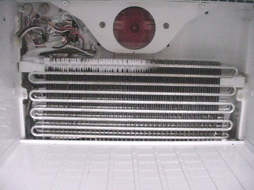

A few days ago I noticed my milk was not cold enough. I also checked the freezer and found our ice cream was like very soft serve. A few things were still frozen. So, we started checking things. The condenser fan was not running. So, we spun it and got it to start. That seemed to help, but it shut off sometime during the night. So, we started it again the next morning. I went to get a replacement fan motor and we installed it last night. The new motor rotated freely, while the old motor was very hard to turn. Seemingly it was about to quit. This morning the milk was colder and the fan was still running. However, the ice cream was still very soft and other things had not refrozen either. I turned the defrost timer and it went through it’s cycle and then the compressor and fans turned back on. I put a 1/2 cup of water in and it froze pretty good after about 3 hours or so. However, other things were still not frozen. So, I pulled the cover off of the coils in the back of the freezer and there was only frost on the bottom 2. The rest of the coils were completely dry and clean.

It does sound like a low freon problem or a partial plug in the sealed system.
Then when the liquid freon enters the coils it is used up quickly and there is not enough of it to cool the rest of the coil so does not get the unit cold enough.

I would not remove it you will probably cause damage if you try to. Dirty coils does not explain why there is only frost at the bottom of the coil.

Adding freon really does not solve the problem as they have to find the leak and repair it or it will just be a temporary fix. Also the leak may be in the compressor itself.
