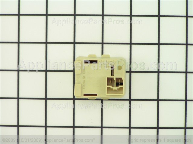

This is the start relay.
Frigidaire 297051000 Controller - AppliancePartsPros.com
Its on the side of the compressor and it pushes onto three terminals that stick out of the side of the compressor.
I’d disconnect the refrig. from power and pull the relay off. If you shake it and it rattles or little pieces fall out of it, its shot.
Order a new one and try it.
