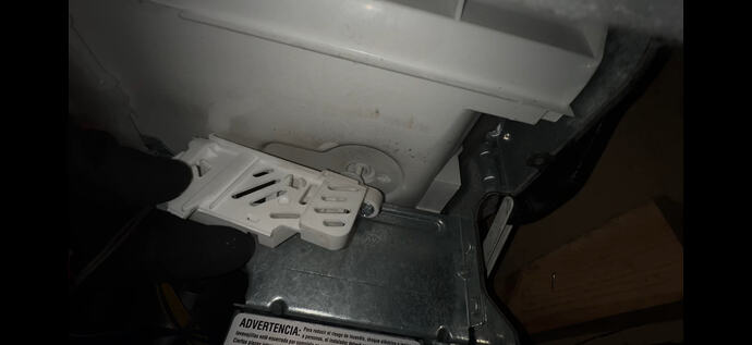

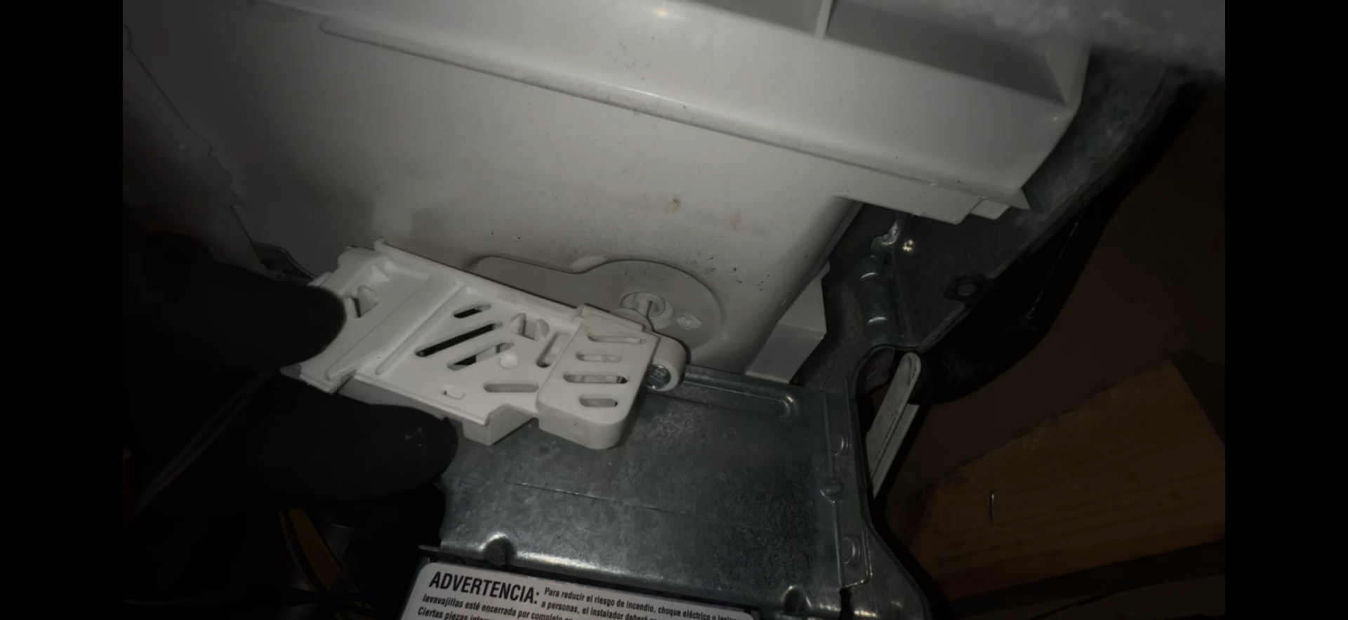

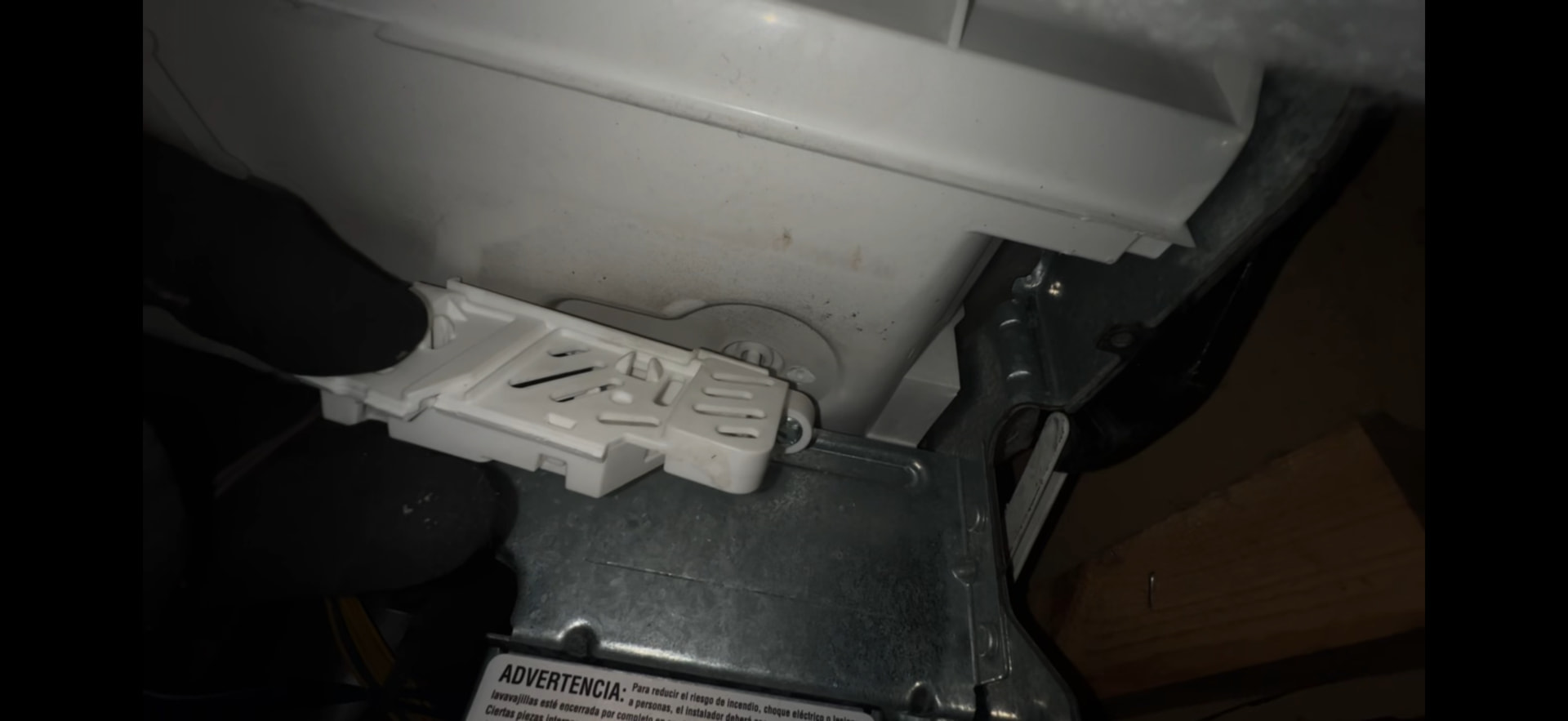

Float switch mount broke
Brand:whirlpool
**Model Number:**WDF310PAAS4
Main Symptom:float switch mount broke
What happens & when:dishwasher fails to fill with water
The float switch mount appears to have broken off and cannot be screwed down in place Is there a replacement part for the broken piece of is it part of tub
Photos / video linkIn
The plastic stud that the mount would have secured to with the screw is a part of the tub. If the model number could be shared, we can see if the tub is an available part.

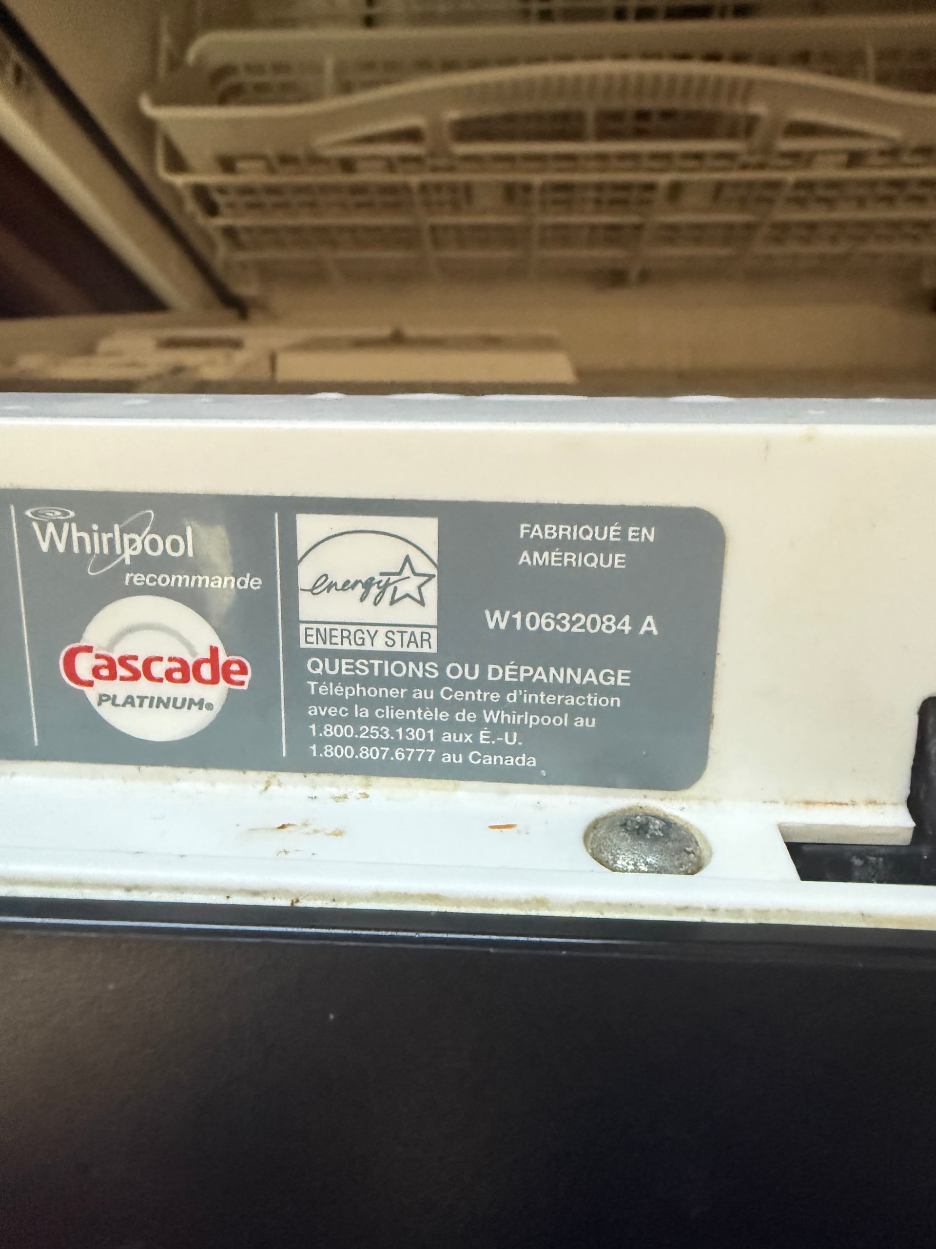

The Model is w10632084a

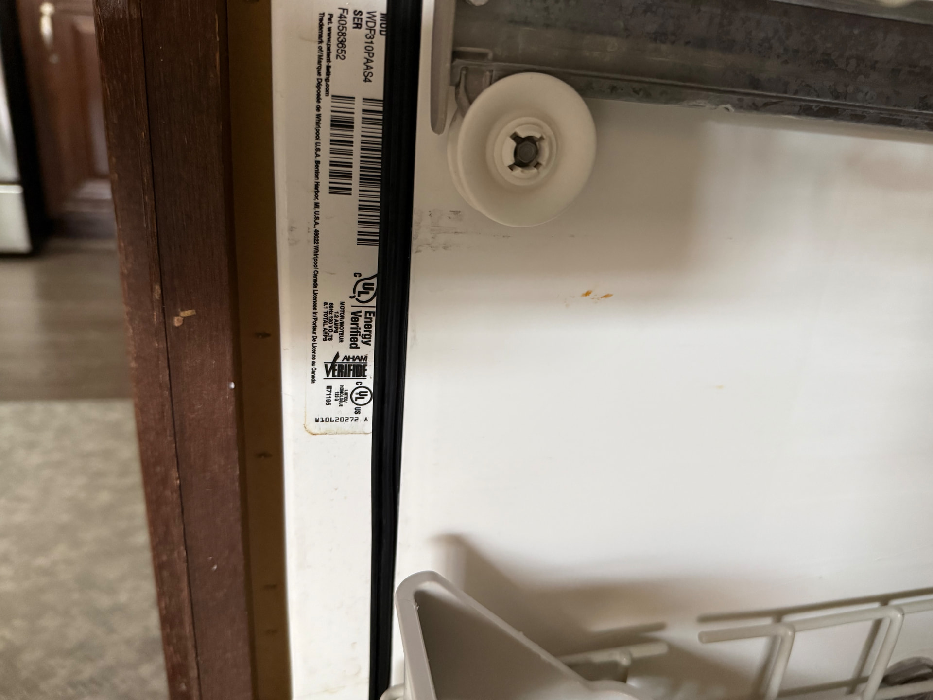

Unfortunately, that is not a valid model number from what I can see in the manufacturers database. Would you be able to provide a picture of the model/serial number tag?
From what I can see, the model number is WDF310PAAS4 and it looks like the tub is still in production from what I see in this link. W10413848 Tub-Dishwr | Genuine Whirlpool OEM In Stock
Thx. Looks like it’d be better to buy a new Dishwasher.
