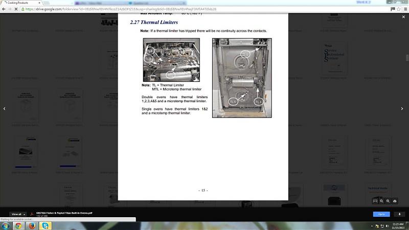

After self cleaning the top oven in a Fisher Paykel double oven, the entire control panel for both ovens went dark. Oven was still getting power. I replaced the microtemp limiter and everything lit up but both of the top oven elements don’t operate. The lights, vent fan and aero fan are working. The bottom oven is fine. Help! Thanks, Steve
There are actually 4 thermal fuses in that oven. The page below shows where they are at. One or more has opened, in addition to the one you replaced.
ScreenHunter_132 Nov. 15 11.23.jpg (33.0 KB)
