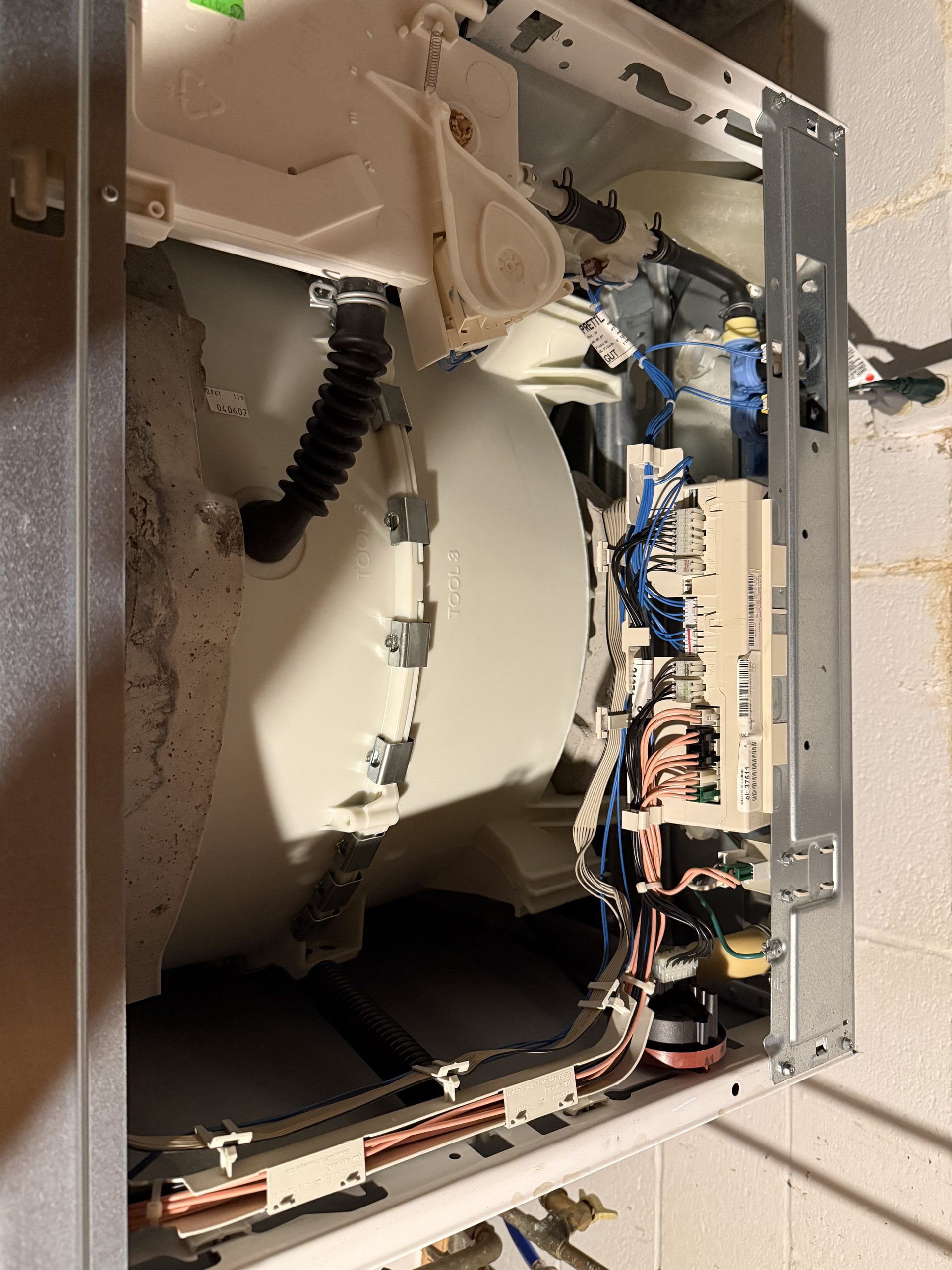

FH code on Maytag washer
Brand:Maytag
Model Number:MFW9700SQ1
Main Symptom:Not filling
What happens & when:it fills very slow and then stops within 5 minutes from the start of the cycle and then flashes FH.
Error Code (if any):FH
Parts or tests already tried: water level pressure Switch, rubber tube for pressure switch, water inlet flow meter

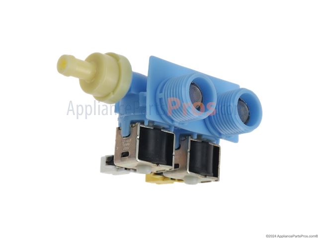

With that code, the machine filling slowly, and what you’ve replaced that sounds like the water valve WP8182862.
Ok, thanks! I will try that.
