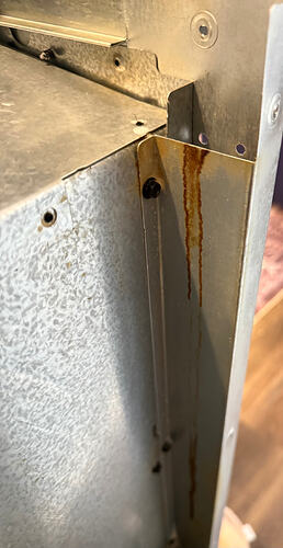

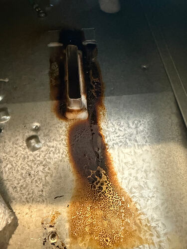

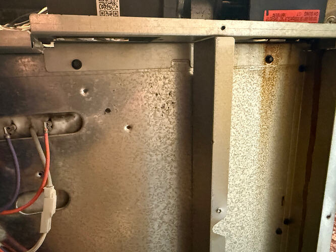

Main Symptom: F97 error continues after replacing a few parts and thoroughly cleaning
What happens & when: Over the summer our double oven started to throw a F97 error. The workaround for several months was to reset the power at the main breaker and to only heat up one of the two ovens at a time. Then the night before Thanksgiving that work around stopped working.
Before I invest any more money, I want to know if it’s gonna make a difference I’ve already spent almost $200. The only other things I can think of are to replace gaskets on the doors, replace two sensors and potentially replace the control panel and the overlay. That would cost probably around $350; I’m on a really tight budget which is why I’m DIYing this
This came with an already used home that we bought and based on the serial number, I believe this double oven was manufactured in January 2018. So I just don’t know if it’s worth putting any more money into it.
HELP!!!
Error Code (if any): F97

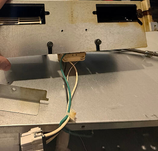

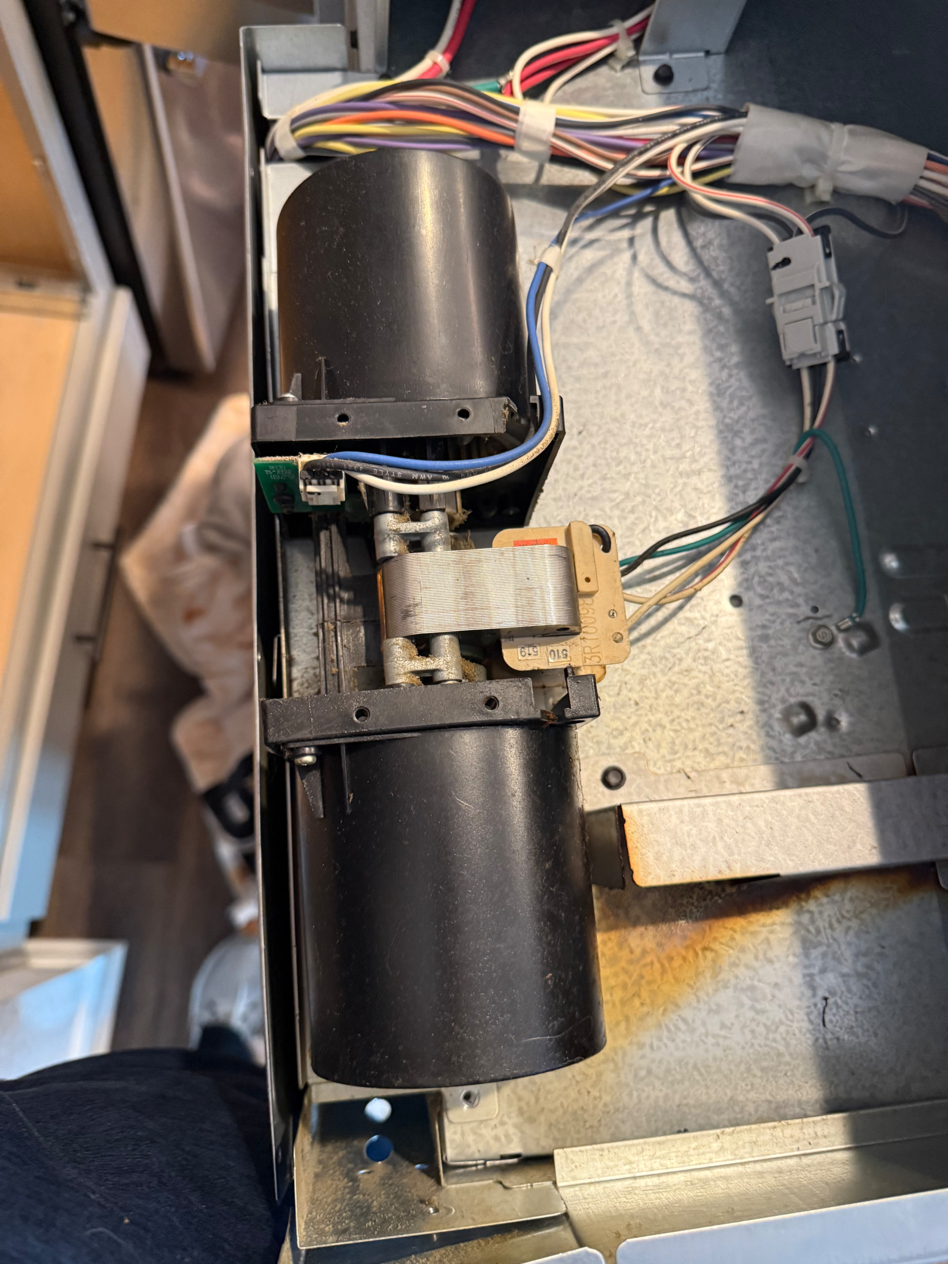

Parts or tests already tried: Replaced lower cooling fan and blower motor; cleaned visible dust and grime/oil buildup.
Photos / video link: Before replacing blower motor.

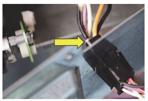

At the cooling fan wire connection going to the main harness, is there a wire terminal sticking out of the connector like in this picture? If there is, will it push in?
Unsure. I, unfortunately, didn’t take pictures of that before reinstalling. I’d have to pull the whole double oven back out from the wall.

If there is, try pushing the terminal in and see if it corrects the issue. If not, and if there is not a damaged wire, the oven control is likely the issue. Here is a link to the control information just in case. WB27X29603 Control Board | Genuine Ge OEM In Stock

For that specific error code, there is nothing left. Either there is a loose wire connection similar to the image, or the control is the failure. It is correct that replacing the overlay is easiest since it can potentially get damaged during the removal process. As far as replacing the parts go, it generally boils down to an individual preference along with factors such as age of the appliance and what has been replaced already.
