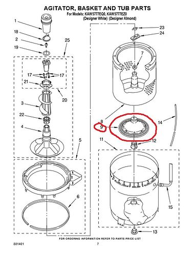

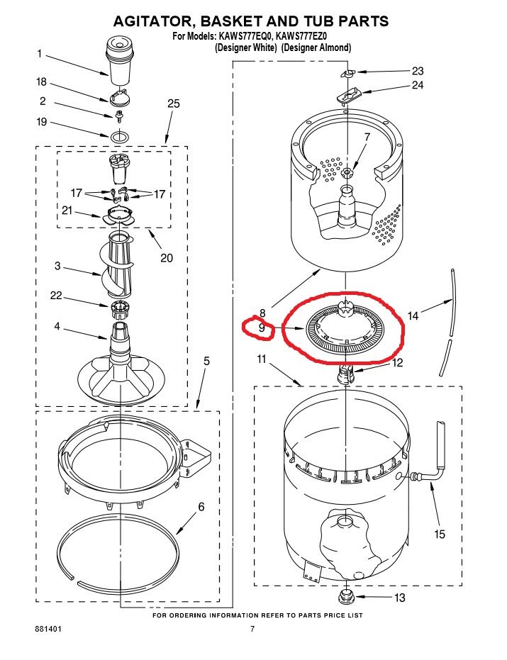

My wife and I just bought a house which came with our KitchenAid washing machine model KAWS777EQ0. We have been washing our clothes and after washing them there is a lot of lint - most noticeable on dark clothes. I have decided I would like to replace the lint screen/filter. After doing some research I see that the original filter part # 3361948 has been replaced by plugs (part # 285868). Picture of the manual below with the original filter circled. My big question is how do you remove the original filter?

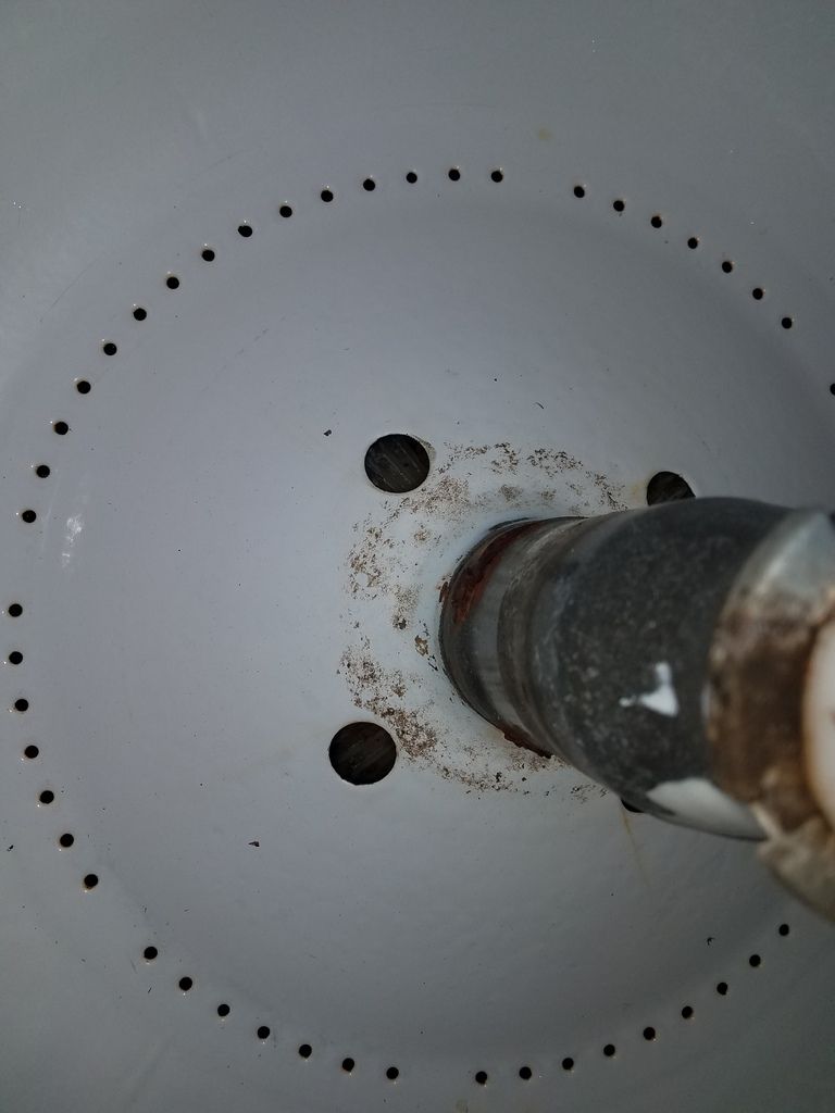

Before purchasing the filters I decided to remove the agitator and take a peek and see if I had the filters and how difficult it would be to put them in. Below in the picture what I saw, no filters.
I see there are no plugs and it appears the original filter is below the basket. In the video on how to install the filter plugs it mentions removing the old filter, but I do not know how to do so and am worried I may be overthinking how to remove it.

The original filter just snaps in the inside of the basket (the part the clothes ride in)
You remove the top of the tub, the agitator, and then the basket. Turn the basket upside down and push in on the four tabs and it should slide up and out of the center hole.

Yours could be plugged up or broken. To find out you are going to need to remove the basket. Once its out you will be able to check its condition.
The were called a self cleaning lint filter. When the washer went into spin, the lint it collected was supposed to come off and be sucked down the drain.

The big part (9) in the parts diagram is what I was talking about. I don’t think any of the newer machines even have them anymore. If your machine was 20 years old maybe. I could be wrong.
