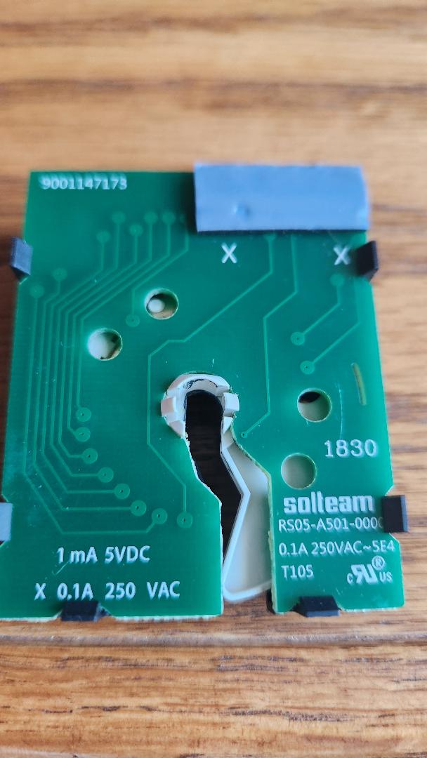

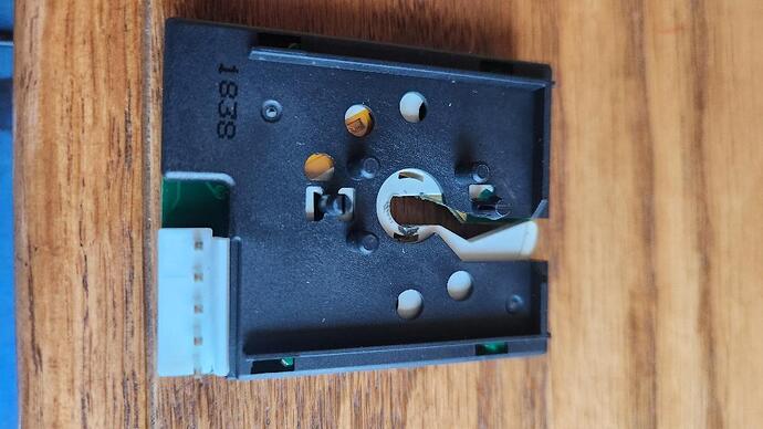

Sorry, forgot to ask this. I have two of the replaced potentiometers. Can I bench test them to see if they show signs of failure or intermittent action? There are 5 connector pins. Do you know how I can test the X-Lo side of the potentiometer? I presume with a Volt/Ohm meter we can check, but it may require voltage applied to the circuit board. See attached photos.
Thanks,Chris

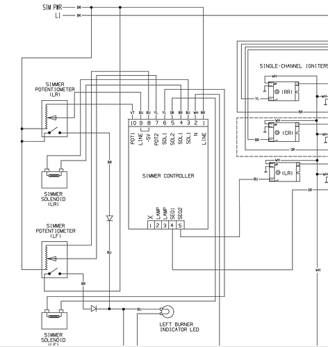

The simmer controller would not affect the other burners. Unfortunately, the wiring diagram does not show which pin connects where in the potentiometer. It only shows the pathway by how the wires are routed. Moisture at the potentiometer can cause enough voltage to pass through to signal to the simmer control that the igniter needs to spark. Is the range being cleaned immediately before the igniter starts sparking on its own? Also, how long ago were the potentiometers replaced?

It’s very possible you’re dealing with a simmer control failure. The simmer control is what sends voltage to the igniters after it receives a signal from the burner potentiometers. Since it’s unlikely that multiple potentiometers would fail at the same time, the simmer control becomes the most probable culprit.
Unfortunately, the only reliable way to confirm this is to test the circuit while the failure is actually happening. That’s when you can see whether the simmer control is receiving the signal voltage when it should not, or if it is sparking on its own.
