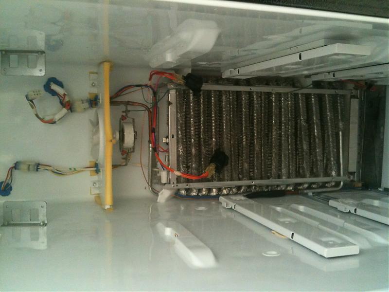

My freezer’s temperature (GE PSS26SGRD) is not going lower than 8-10 and my refrigerator temperature is 45. I did the following tests using multimeter and J2
Put the black in 3rd, Red in 8th pin, it read 13.6 V. Opened the door for 3 minutes, heard the fan moving. Put the black in 3rd and red in 4th. Instead of reading between 8-12 it read 13.6V. What does that mean? I tried black in 3rd and red in 5 that also came 13.6 volt. What does that mean? One of the fan is not moving I can see as I have opened the freezer panel and removed ice maker. This I am assuming is Evaporator fan. Not sure about condensor fan. Also when I start my refrigerator I can see frost on the coils within a few minutes. If this all relates to just evaporator fan, can you please let me the model number of the fan?

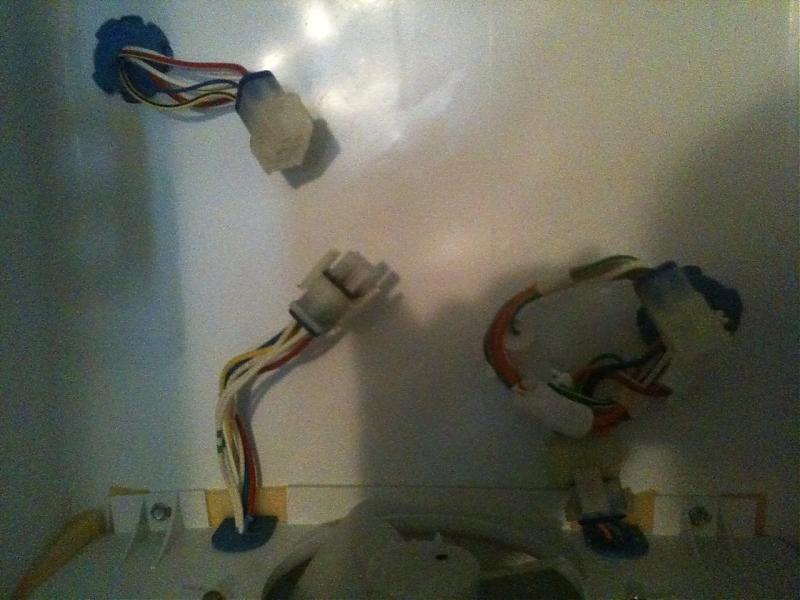

In bullet 4 of “The evaporator fan motor test procedure:” it says “Check for 13 VDC from the red to the white wire and between 8 to 13 VDC from the white to the yellow wire at the evaporator fan connector.” Can you please elaborate on this? If I am looking at the right harness (please see picture attched) there are 2 reds, 2 whites, 1 blue and 1 yellow/white striped wire. Also if you can let me know which wire from multimeter goes in which pin for testing, I will really appreciate it.
Ignore the white thermistor wires, check the others per. the article, a missing or lack of a 6 volt signal indicates a bad motherboard.
So I got the new evaporator fan and replaced the old one. Before putting the freezer panel back on and putting the ice maker in place, I want to make sure this fixes the issue. When should I see the fan running? I turned on the refrigerator, put the thermostat to lowest settings and now am waiting to see if I can hear/see fan rotating. How long would I need to wait to check if it is working?
Your old evaporator motor blew out the motherboard, fan motor will not work without a new board.
Thanks for your feedback guys. Within 10 minutes of changing the fan motor, I could see the fan moving and my refrigerator is now a good as new :slight_smile:
