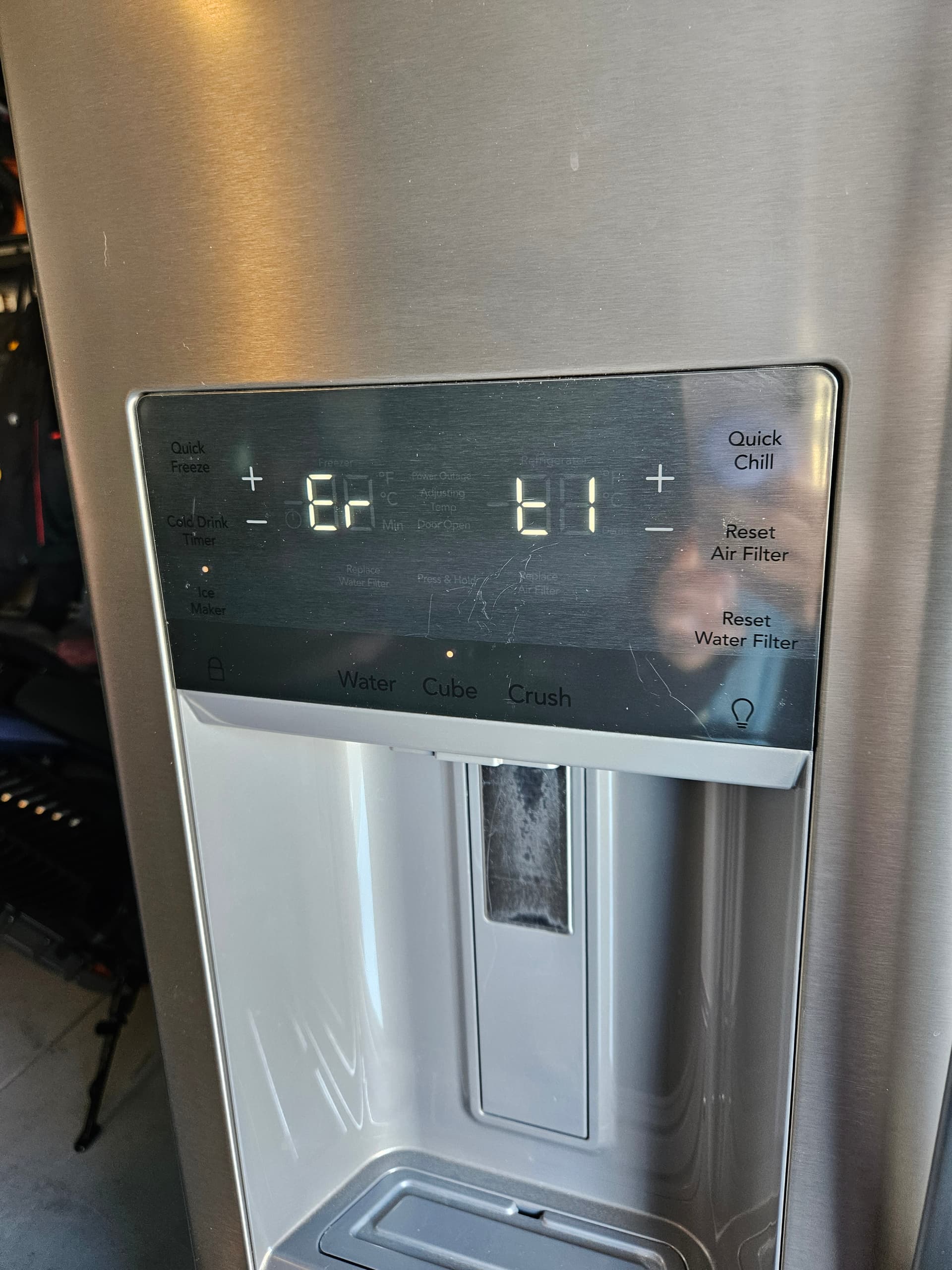

Error Code on Frigidaire Gallery FG4H2272UF
Brand: Fridgidaire
Model Number: FG4H2272UF
Main Symptom: Top fridge is freezing food
Error Code (if any): t1
Parts or tests already tried: Replaced main board and thermostat
Trying to figure out what this error code means and if replacing the thermistor will help
This error code refers to the thermistor circuit. Check the thermistor for proper resistance, this could also reference a wiring issue in this circuit, or a control board failure. This testing should be done with a multimeter.

How do we access the thermistor in the freezer section?
