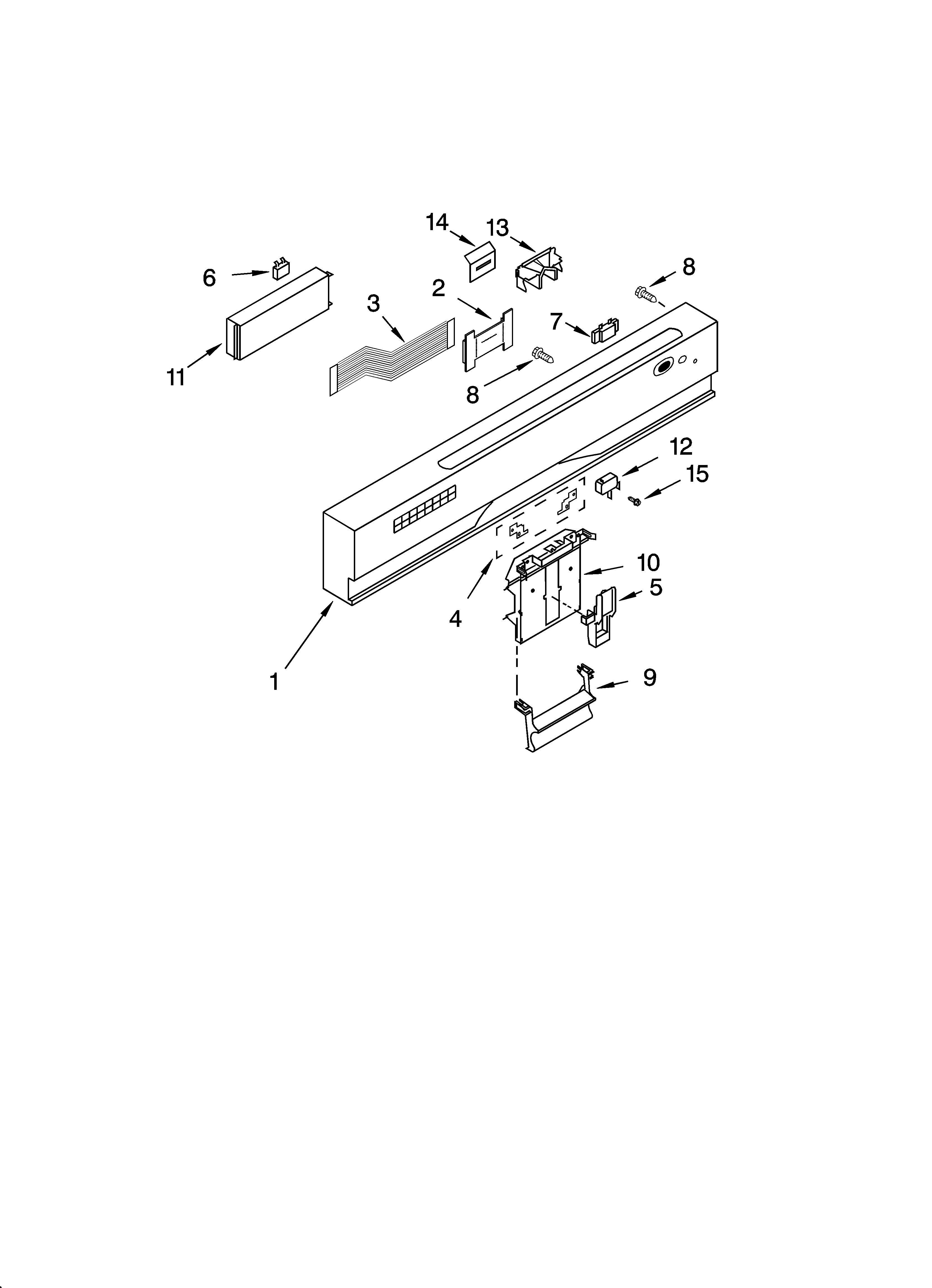

My kenmore ultra-wash wont turn on or display - like it has no power source (i verified it does). I took apart the door and panel parts and noticed condensation on the circuit bd (not much). I cleaned the vent assembly plunge seal, cleaned and dried all parts.
I noticed the control box had a three prong white little box that had a plastic guide opposite the little prongs that was sheared off. it looked like a guide but was this the thermal electronic fuse? if not Do i need to take apart again and find the fuse and check it out?
any help wouild make peace with all girl family.
There is a thermal fuse (#6 on the diagram)
  • The part number for the thermal fuse is AP3178588
