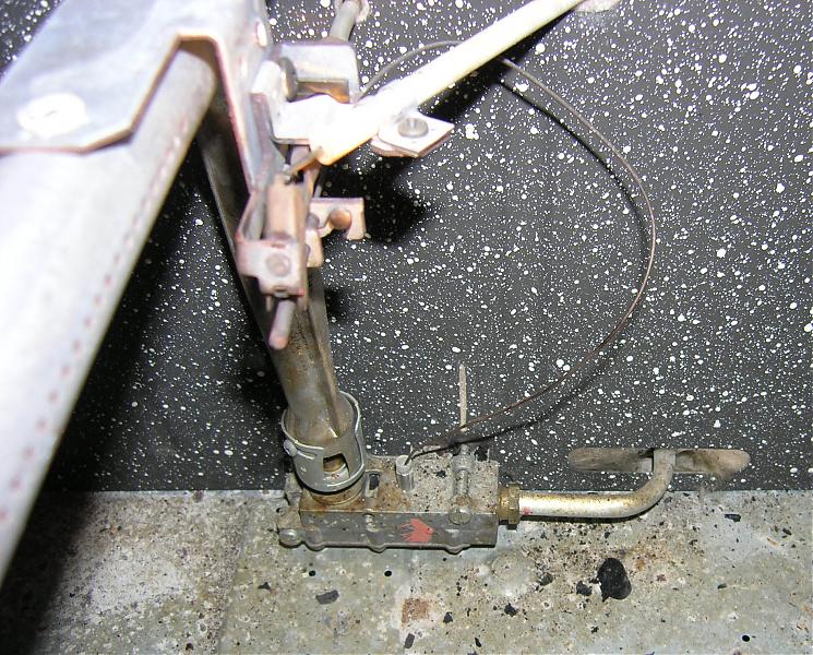

We need to know what kind of ignition is in your oven. Remove the oven floor and the flame spreader to see it. Post the result. If you can post pictures, it’s even better.
Hi Gene,
Here are the pictures of the Hardwick (Model #CK89642K C640R) ignator.
Looks to me like a Regular pilot with Thermocoupling???
I hope that you can resolve this puzzle.
Thanks, vsuboni
If it does not click then the problem could be a bad ignition switch (under the oven temperature knob) or a bad spark module (under the top panel or on the back of the range). There are no diagrams available on-line for this old model and I can not give you more specific information.
The first thing I would do is find the ignition switch and bypass it. If it would click then the problem is the switch. If not, then it is the spark module.
If you can post pictures of the switch and the spark module then we probably can find a replacement parts.

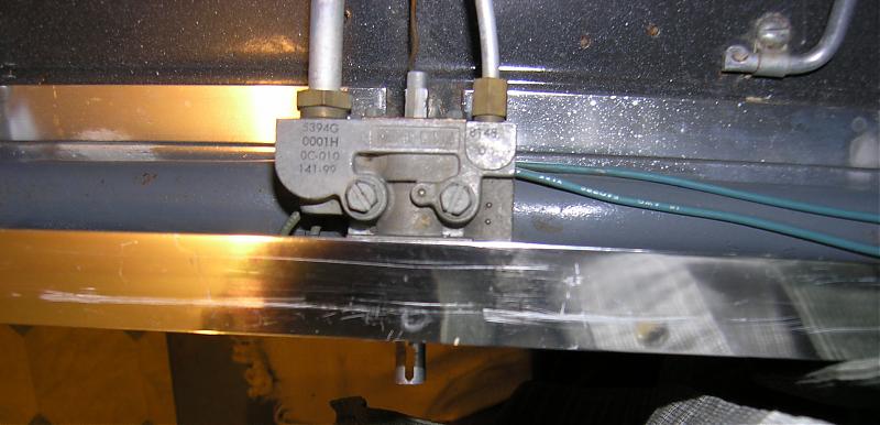

[COLOR=#333333][FONT=Arial]Hi Gene, [/FONT][/COLOR]
[COLOR=#333333][FONT=Arial]The bypass (the 2 blue wires) for the switch does not work.[/FONT][/COLOR]
[COLOR=#333333][FONT=Arial]Here is the Module under the oven temp knob MADE by: Harper-Wyman #8148D[/FONT][/COLOR]
[COLOR=#333333][FONT=Arial](some other # on the module: 5394G[/FONT][/COLOR]
[COLOR=#333333][FONT=Arial] 0001H[/FONT][/COLOR]
[COLOR=#333333][FONT=Arial] 0C-010[/FONT][/COLOR]
[COLOR=#333333][FONT=Arial] 141-99 )[/FONT][/COLOR]
[COLOR=#333333][FONT=Arial][/FONT][/COLOR]
[COLOR=#333333][FONT=Arial]I believe the switch and module is one piece.[/FONT][/COLOR]
[COLOR=#333333][FONT=Arial]Thanks, vsubon[/FONT][/COLOR]
The part on the picture is the oven thermostat. The shaft on the bottom of the picture is where the switch should be. The spark module is electric part without any tubes and a few wires connected to.

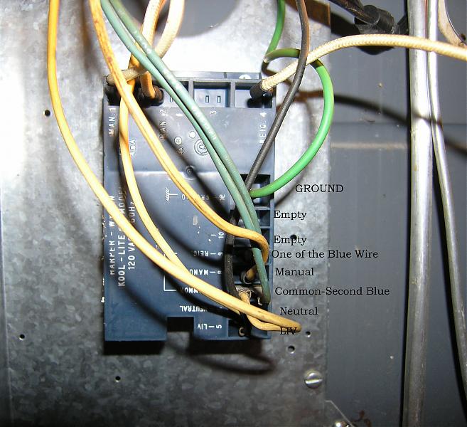

[FONT=Times New Roman][SIZE=3][COLOR=#000000]Hi Gene,[/COLOR][/SIZE][/FONT]
[FONT=Times New Roman][SIZE=3][COLOR=#000000]Those two blue wires from the ignition switch are leading me to the rear panel.[/COLOR][/SIZE][/FONT]
[SIZE=3][COLOR=#000000][FONT=Times New Roman] The panel # is 6515 4mA[/FONT][/COLOR][/SIZE]
[FONT=‘Times New Roman’][COLOR=#000000]They are connected to a blue plastic panel see pictures[/COLOR][/FONT]
[FONT=‘Times New Roman’][COLOR=#000000]COULD BE THIS ONE???[/COLOR][/FONT]
[FONT=‘Times New Roman’][COLOR=#000000]Thanks, Vasa Suboni[/COLOR][/FONT]
1-6515 4mA Control.jpg (66.3 KB)
1-6515 4mA ControlA1.jpg (69.9 KB)
Yes, you found it.
