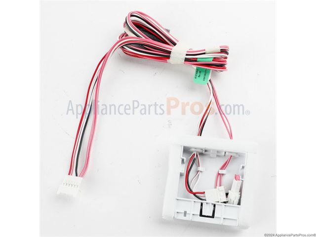

It uses magnetic reed switches Frigidaire 5304527992 Refrigerator Harness With Reed Switch (Wire Harness) | Genuine OEM Part ) embedded in the cabinet wall near where the door closes

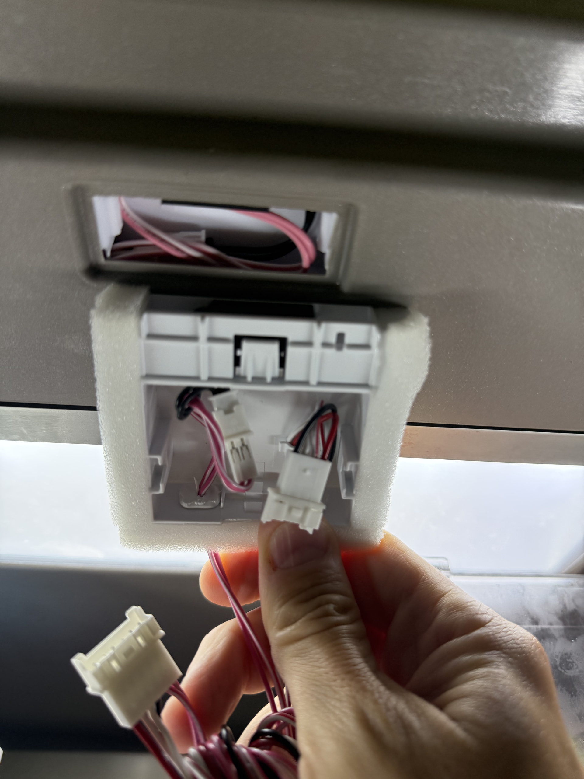

Doesn’t appear to be right switch. It’s too big for the little compartment. Don’t see option to add a picture, but compartment is 2” W part recommended is 3” W. Is it possible it is installed by taking down the LED light in ceiling? I don’t see how else this would go in unless it’s not the right part.
Yes it is located in the top center
The reed switch port is too small for this port. Does it get installed through the light compartment instead?
Yes I do believe so. If it doesn’t fit that way let me know
When I remove the LED light in ceiling, there’s a white plastic insert in ceiling. No access to reed switch. Other ideas?

Can you unplug and remove just the reed switch from your fridge and then take the reed switch out of the bow on the new part and install it where the old reed switch was?

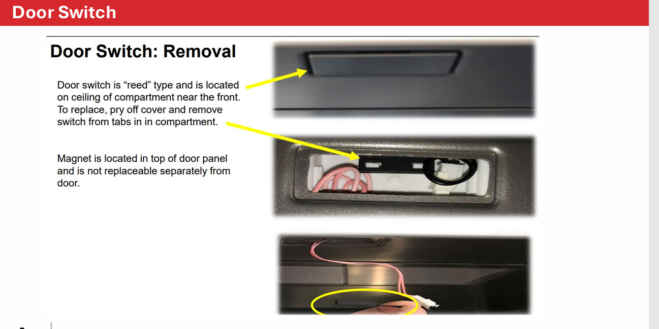

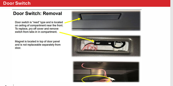

This isn’t accurate, it’s not in the cabinet wall.
Previous comment was to the response that the switch was in the cabinet wall.
Can you send pictures of what you’re seeing. All of our literature shows the reed switch is located at the top dead center of the fridge door opening, The part I gave you is for the switch and housing
Did that work? Tried uploading picture but not seeing it yet.
RFTT2101_EI33AF80WS_EI33AR80WS_FPFU19F8WF_FPRU19F8WF.pdf (353.5 KB)
On the attached video the reed switch is at about 8:45
