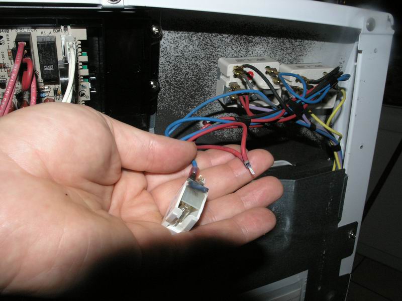

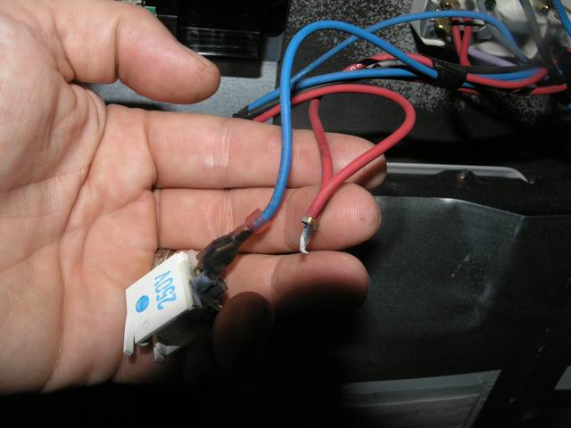

Well I put the clock in. Tried the oven and lo and behold it lit the bake element and started to heat up. Then I did something incredibly stupid. I started to put the metal back panel bacl on without unplugging the oven.
There was a spark and when I checked out what happened it looks as though the lead that goes to the stove top “ON” indicator made contact with the back metal plate and soldered itself right to it.
I dont know if the oven still works because I have not plugged it back in. My question is can the oven work with that indicator light connection bypassed? What do I with the disconnected wire? Can I get the metal clip piece at a hardware store and reattach it?
Resize of PB132964.JPG (65.3 KB)
Resize of PB132965.JPG (37.0 KB)
Resize of PB132966.JPG (59.2 KB)
It probably will work without this indicator light. At least you can try. Insulate all wires, using an electric tape and turn it on. This light is probably gone.
Gene,
thanks for your reply. I cut back the two wires that would hav attache dto one of the leads to the light and I wrapped them in electrical tape. The oven appears to still work and the cooktop but neither the cooktop “on” or the “hot surface” indicators work. No big loss as I am just happy to have an oven again. Thanks for all your help. I hope “appliance parts pros” pays you!
David,
I’m glad you were able to fix the oven. You can replace this indicator light and they both will work.
