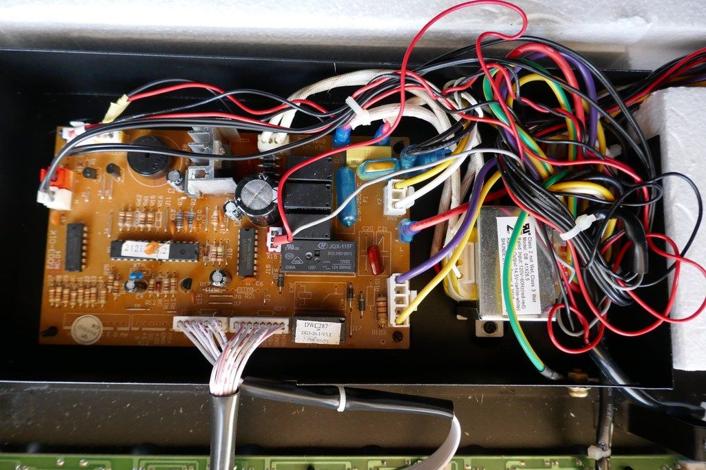

  1. I pulled the circuit board and tested all the caps and diodes. Everything tests OK. While I had all the leads disconnected, I tested both thermistor temperature sensors (it is dual zone) by connecting to the leads on the white and red plugs at the left of the board (see below). I then blew a hair dryer on each sensor for a few seconds and verified that the nominal (room temperature) 2.5 k-ohm reading changed. They are most definitely working.
Here is a picture of the control board:

  1. I think the control board is operating correctly.
  2. Both fans are definitely working and both blow into the compartment.
  3. Both temperature sensors test OK, and the sensors and board, working together, seem to be trying to do the right thing as the temperature goes above and below the set point.

The one final thing I am going to try to figure out is whether I can turn off the defrost for the upper section. It is a total waste of energy to have the defrost heat applied to that condenser. I wasn’t able to determine which connector on the board I need to fiddle with, but I suspect it may be one of the wires in one of the two connectors next to the transformer.
I did have to unplug the upper defrost coils because, now that I have hard-wired the temp sensor in the malfunctioning upper zone to always read 41 degrees, during the defrost cycle, I think the controller board is looking for some increase in temperature in order to terminate the defrost. When it gets no increase, it keeps the heat turned on. The upper unit reached well over 100 degrees F. Since there is no reason to have a defrost cycle for the evaporator that receives no cool Freon, I unplugged that defrost coil and everything works fine.
The plugs for the two defrost coils (one for each zone) are Molex plugs located in the rats nest of wires next to the transformer. I didn’t know which one to unplug and was too lazy to take the back panel off again, so I guessed. Unfortunately, I guessed wrong and a few hours later found the upper unit back to 100 degrees. I re-plugged that zone and unplugged the other and this time everything is working just fine.
[edit]I also decided to un-plug the upper (bad zone) fan because it seemed to be running continuously. The lower fan cycles on and off when the compressor is not running which I think is the normal operation. I figured there is no upside to letting the upper fan run 24/7, blowing air into the empty, non-functioning, upper zone.
