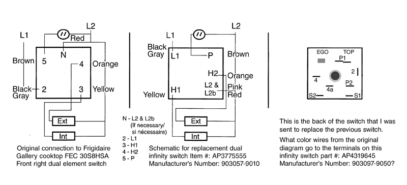

I am posting pictures of the old and new switches. I have identified the color wire that hooks to each terminal on old switch. I do not see the # terminal highlighted in your post. Any help is appreciated.

I have a Frigidaire Gallery Cooktop and replaced the dual switch number 903057-9010 twice now. I ordered a third switch and received part number 903097-9050. I was told it replaced the previous part. It is a much sturdier switch but I cannot find a wiring diagram for it (I spent half a day calling and searching online). Your recent post describes wiring for the 903057-9010 switch and I have that diagram, but the 903097-9050 connections are different from that and the original switch.
Please tell me what color wires connect to the following terminals on the 903097-9050 switch: P1, P2, S1, S2, 4 and 4a. Or send a diagram if available. Thank you, stevenmh
I have a Frigidaire FEC 30S8HSA cook top. The front dual burner switch has broken three times, the original and two 903057-9010 switches. I ordered another switch and they sent me a 903097-9050 switch. Attached are the original and 903057-9010 wiring diagrams. Please tell me how to wire the 903097-9050 switch to the FEC 30S8HSA cook top. Thank you.

According to the manufacturer part number 903057-9010 doesn’t sub to 903097-9050. So you may have the wrong switch.
According to your model the final replacement switches are 903057-9010 and 318120505. Which means the 903097-9050 doesn’t belong to your model.
If you purchased it from us please call our toll free number 1-877-477-7278 and one of our qualified representatives will be glad to assist you.
