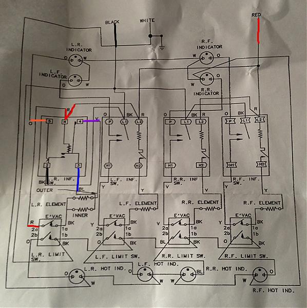

[QUOTE=Gene;796050]Hi Charlie,
I would start from determining which wire where goes on the stove. Which wire is In and which wire is Out. The picture of the old switch you posted is not very clear.
Gene.[/QUOTE]
Red cable goes to terminal N on the old switch
Black Cable goes to terminal 2 on the old switch
Orange cable goes to terminal 5 on the old switch
Violet cable goes to terminal 4 on the old switch
Blue cable goes to terminal 3 on the old switch
I upload an image of the original circuit somewhere in this post you can see the circuit of the replacement switch, if you can’t find it I’ll scan it and upload it.
thanks in advance for your help
