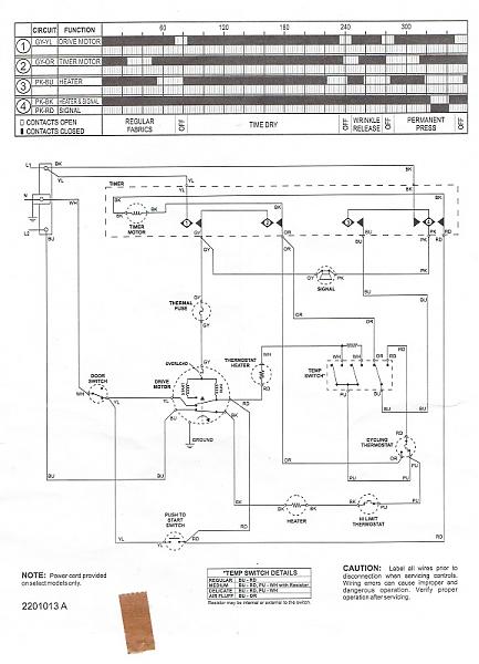

My Amana dryer (NDE2330AYW) stopped working in the middle of a drying cycle and would not start back up. Testing the high limit thermal fuse w/multimeter found it to be open, so I replaced that along with the high limit thermostat (as recommended in the service manual). At this time also noticed the insulation on short black wire connecting the heating element to the high limit thermostat was showing signs of heat damage on the end connecting to the heating element, so I replaced that as well.
Dryer started immediately after repair and ran with heat for nearly a full cycle (~60 minutes) before the breaker tripped. Dryer would not start back up immediately but after a period of time (60 minutes) it started again but took an exceptionally long time to dry clothes.
In the days following the dryer would routinely start and heat (testing with a meat thermometer in the dryer showed temps over 200 degrees) but would not stay on for more than 5-10 minutes - it also would not start back up immediately after - suspect a thermostat had been tripped and the temperature needed to cool down before allowing restart. The dryer door also being opened would not stop the drum from spinning. I disassembled the dryer again and did the following:[LIST]

    amana dryer wiring.jpg (41.4 KB)

Cletus -
In trying to figure out why the breaker is tripping, I tested every wire for continuity on the wire, as well as continuity to the metal frame. Every wire looks and tests ok, except a white wire that originates at the middle connector on the terminal block (see attached photo). This wire splits at the terminal with one end going to the door switch and the other going to the timer. These wires tested for continuity when connected to the metal frame. Would they be the cause of the short that trips the breaker, or is this a natural continuity given that also connecting to this middle connector on the terminal block is the ground wire?
I again tested the door switch and it tests 0 ohms so I feel confident that the switch is not what is keeping the drum turning when the door is open. The white wire that feeds the switch that I mentioned above as showing continuity with the metal cabinet - could that wire be the cause of the door switch not stopping the drum spin?
Is there a way to test the motor to determine if it is bad?

Let me look at the diagram and get back to you. As far as the thermostats, many people replace all the components at once if they are replacing the fuses just to prevent further issues.
The cycling thermostat is opening and closing so it may be okay, and it may be labeled with the upper limit number.
A bad thermostat or switch shouldn’t cause a breaker to trip though.
Just to close the loop on this issue for anyone else who might encounter similar issues, in my case the problem was something within the timer (not the timer motor but the timer itself) - replacing the timer resulted in the dryer no longer tripping the breaker; it also resolved the drum not stopping its rotation when the dryer door would open.
