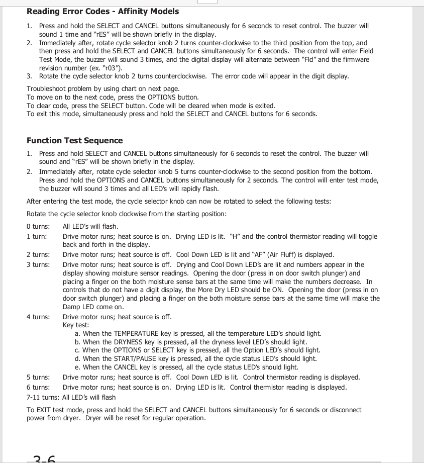

Dryer stops with lights flashing
Brand:Frigidair
Model Number:FAQE7011KW0
Main Symptom:lights flashing and won’t cancel
What happens & when:sometime in
Error Code (if any):can’t get into reading error codes
Parts or tests already tried:disconnected power and it sometimes works for a while after reconnecting the power.

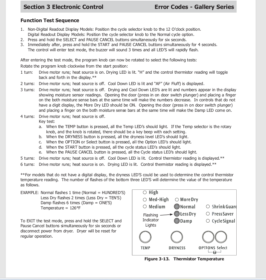

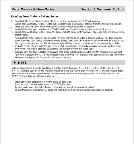

Hi, I’ve sent you a tech sheet for your Frigidaire dryer model FAQE7011KW0. Follow the steps to put the dryer into diagnostic mode and check for any stored error codes.
I unplugged the dryer over night, In the morning I connected the power and after about six hours the lights stated flashing. Following flow chart it indicates that the control board needs to be replaced. I did get some error codes to display but they didn’t match any from the chart, E01 and E68.
