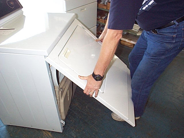

do this: [ATTACH]455[/ATTACH]

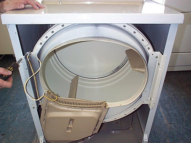

then you can do this: [ATTACH]456[/ATTACH]
Look for the slides along the front of the drum after you have removed this: [ATTACH]457[/ATTACH]
This is basically what you have in there but it might not be the exact model. You get the idea though right?:smiley:
