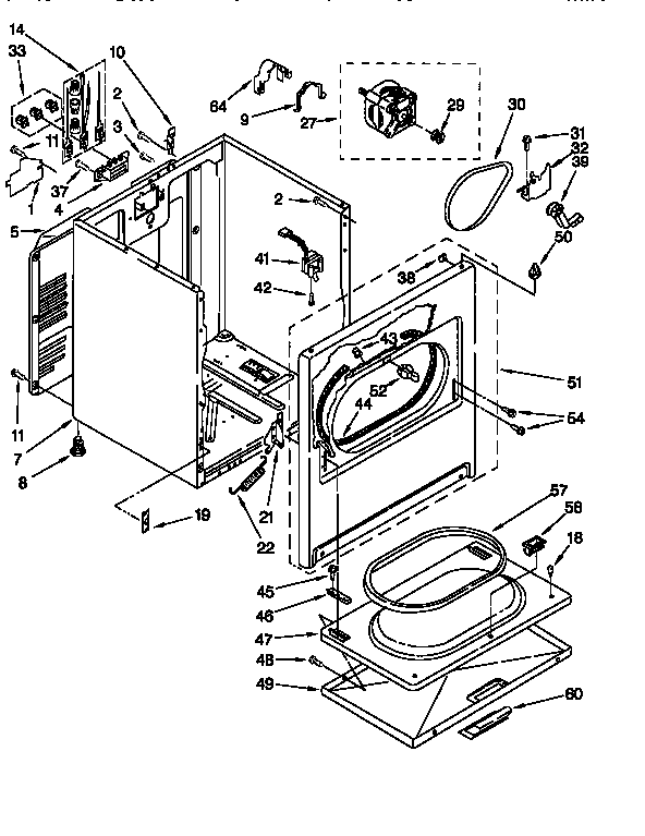

Remove the terminal cover (#1 on the diagram). Measure the voltage at the terminal block (the dryer door open) between the central wire (neutral) and each end wire. It suppose to read about 120 VAC. Measure the voltage between the end wires. It suppose to read about 240 VAC. Post the results.
