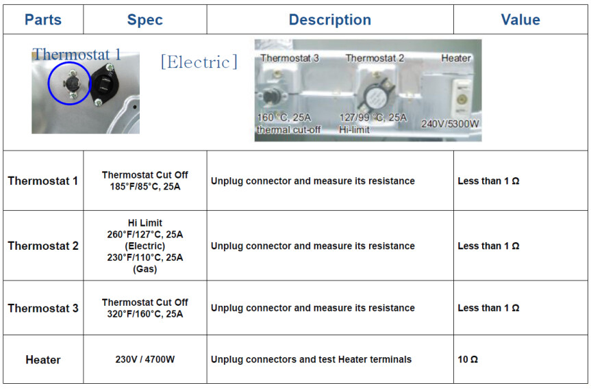

Dryer is not heating
Brand: Samsung
Model Number:DV42H5000EW/A3 04
Main Symptom:Does not heat
What happens & when: dryer runs no heat
Error Code (if any):none
Took off dryer vent hose to make sure no lint build up, all is good.
I’d start by checking the continuity of the heating element and thermostats, I’ve attached a little cheat sheet that should help.
DV42H5000EW A3
hello, I currently have a Samsung dryer that is not producing any heat. I am trying to order the right parts. I put an order on hold right now. The heating element is out of stock so I’d have to buy the whole kit which is $230 otherwise I have purchased the high limit thermostat, the dryer thermostat, and the dryer thermostat or temperature sensor
I know that testing for continuity would be the best answer that one could provide but as of right now it is stocked up on top of the washer and is inconvenient and I’m just a little busy so I was wondering if I’m basically recommend if I should just go with my current order, which is on hold or if I should cancel like the high store and go with the kit it’s just $230 is a lot of money and I’m just wondering you recommend I’ve attached my model number as well as my receipt confirmation in my order confirmation and would love any recommendations on next steps again. The heating element itself which is $87 is on backorder and was trying to get it obviously as quick as possible so my lady can dry her clothes
