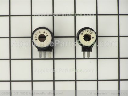

Mvetri – If your dryer igniter glows but gas valve won’t open, the likely cause is bad valve coils. If igniter does not glow, could be due to a bad flame sensor or igniter itself.
coils:

I have a Maytag dryer that the igniter comes on,glows and the gas will not light.If the unit is shut off for about 10 min. or so the burner will ignight but will only stay on 2 min. and then will go out.I was wondering if the coil kit needs to be replaced and what is involed with that.It appears that they are plug in electric parts?Where are they located?(by burner?)
I have the same problem…heats up once but next time the ignitor glows there is no gas. Is that the coil or a sensor?
