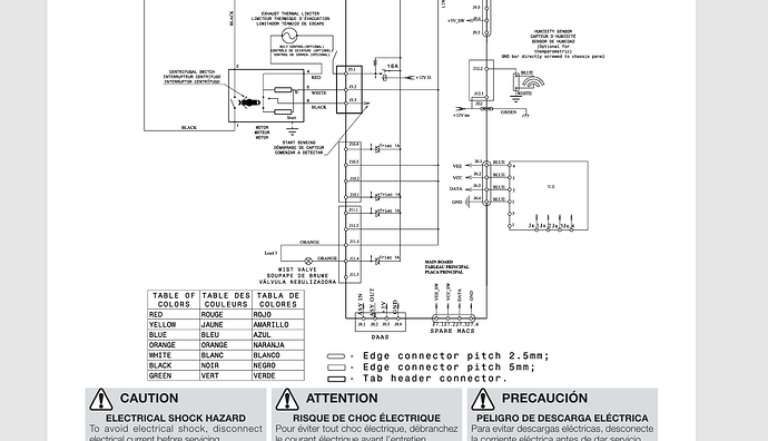

I’ve attached a tech sheet to help with the diagnosis. 2 diagrams gas/electric
Thanks for the data sheets. While I had access to the inside of the dryer, I did a service, cleaned the drum felt, door felt, cleaned the drum wheels (lightly lubed) cleaned the motor and vacuumed up any debris. I have power to the motor, control board, up to the interface board (wiring harness connector) power to the door switch and lint sensor. I was able to spin the blower wheel with my finger, (belt was not hooked to the motor at the time) Any thoughts on the grinding noise when everything is together and I spin the drum by hand? Could that be a bad motor?
