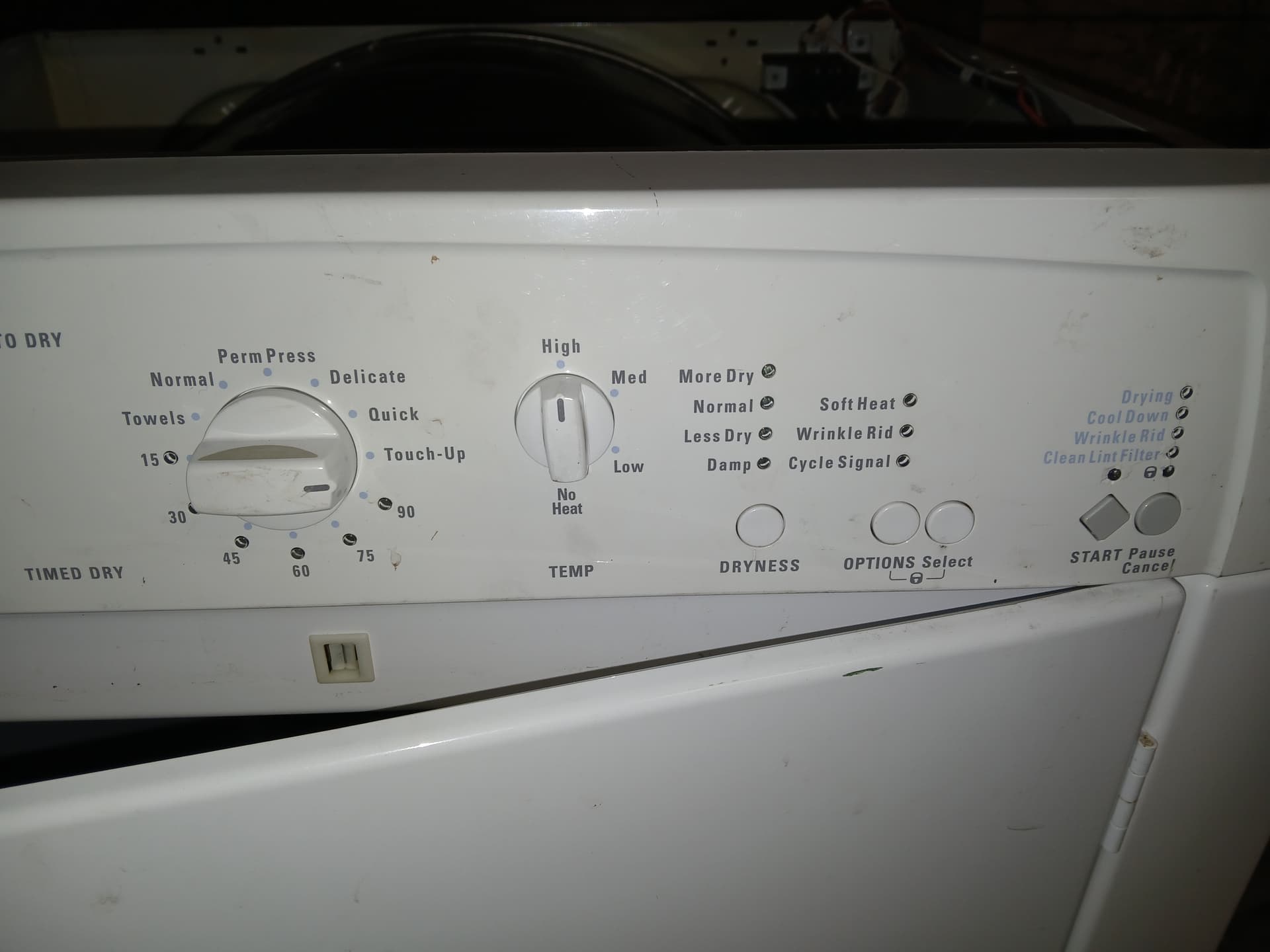

Dryer Control Board LEDs not lighting up

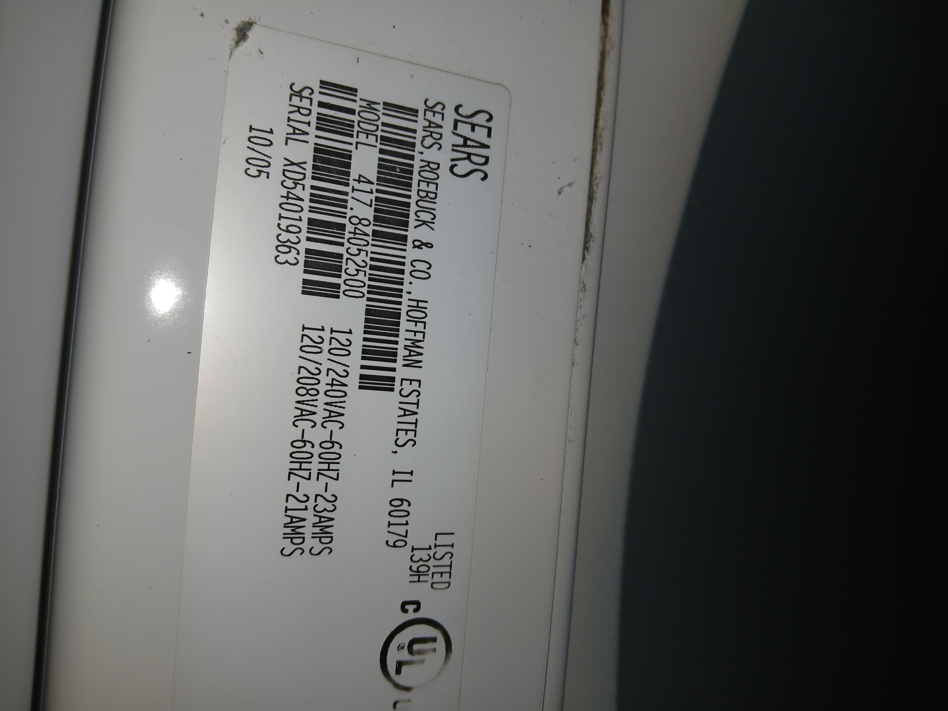

Brand: Kenmore
Model Number: 41784052500
Main Symptom: Not Turning On

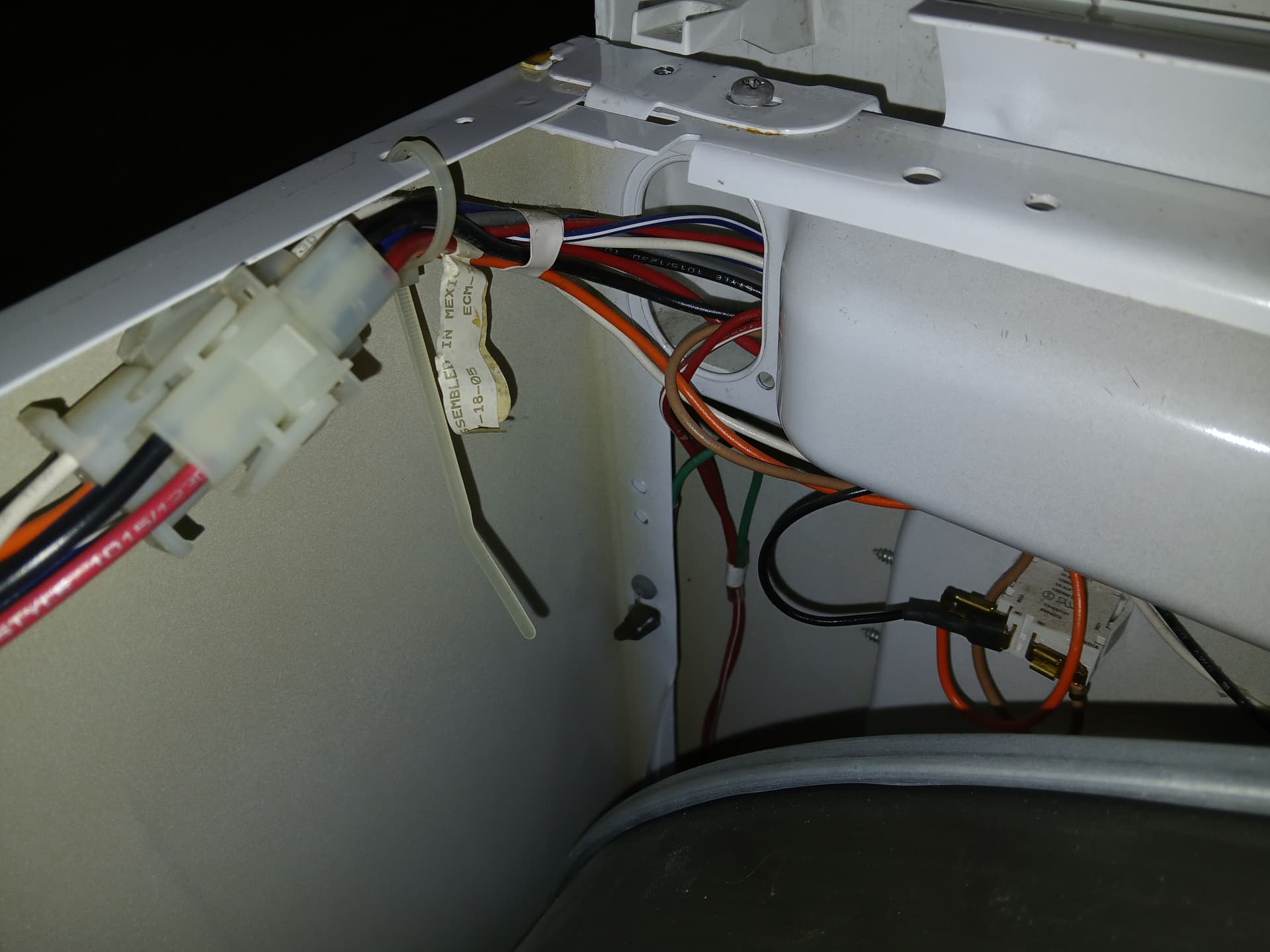

What happens & when: The dryer was working a while ago but it would not shut off via the timer. I had it unplugged and did not use it for a while and when I tried to use it again I got no LED lights on the control board. I get 240 volts to the terminal and when I unplug the red and black wiring harness clip at the top I only get about 60v, I’ve tested Thermistor and Heat Limiter Fuse for Continuity and got a reading. Tested the control board main leads (Red and Bblack and got no continuity reading) but i think I may have tested the wrong leads for this. I ordered a refurbished control board from eBay and when I installed that still no LED lights lighting up on the control board. The light that turns on when the door opens is not turning on and I thought its a bad bulb but after this I am unsure if its something else. I also tested the door swtich for contiuity and it also gave a signal.

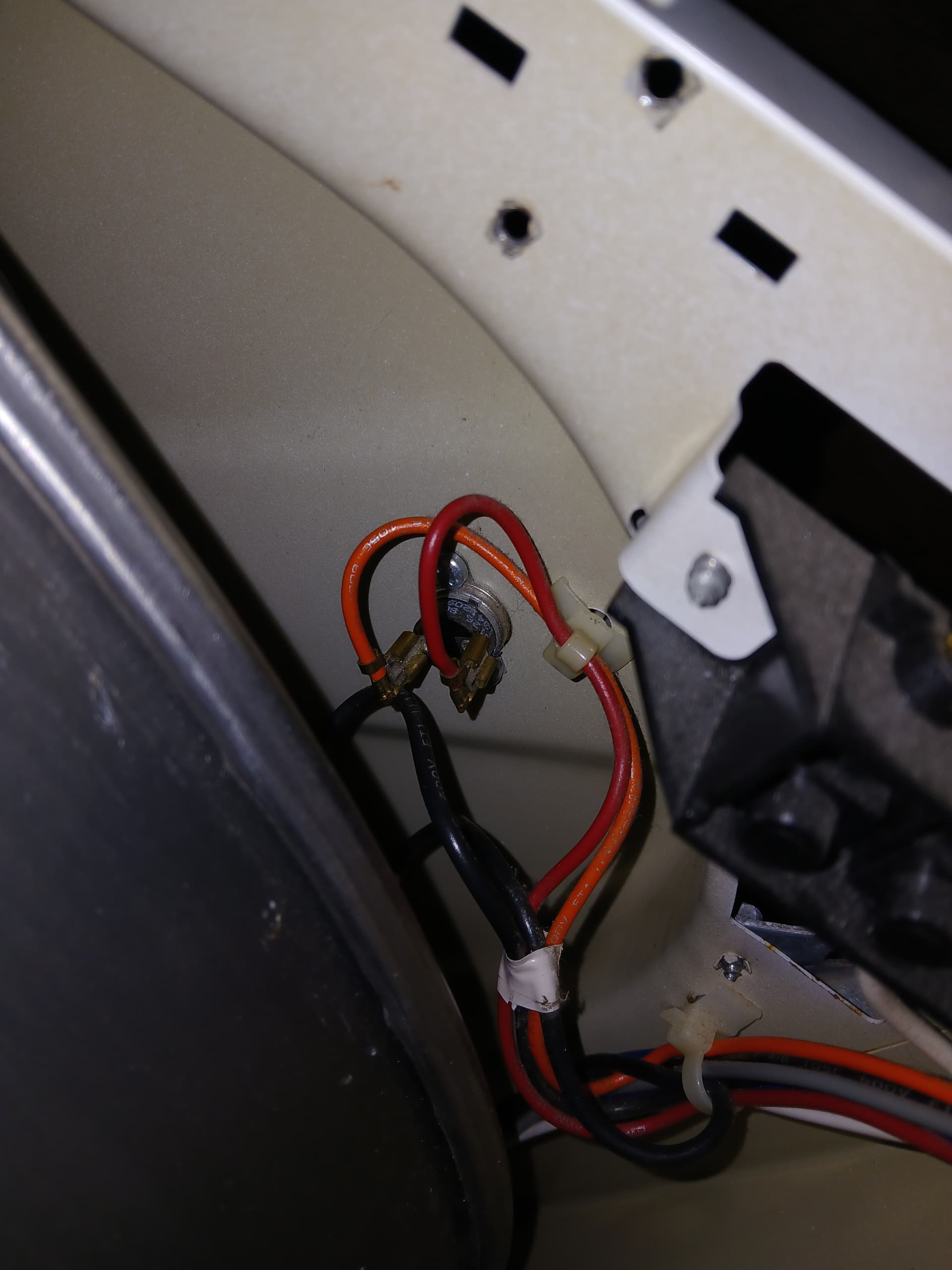

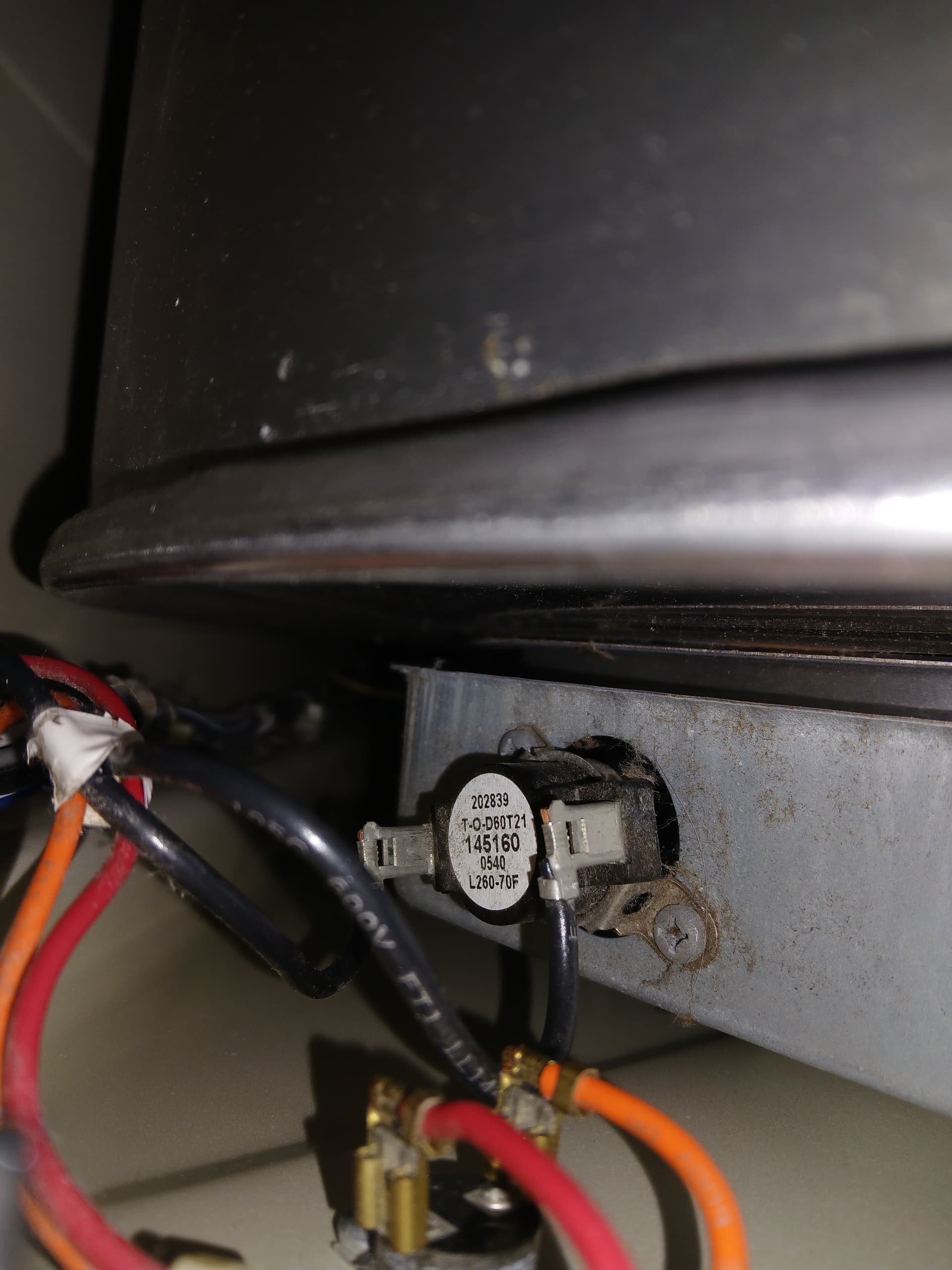

I’ve added some pictures to help with the troubleshooting and also to the parts i tested, I’m not 100% sure that the 2 pictures shows the thermistor and heat limiter, I’ve read that if these are bad the dryer wont even get power but like I said I got readings when I tested for continuity.

Parts or tests already tried: Tested Thermistor and Heat Limiter Fuse for Continuity and got a reading. Tested the control board main leads (Red and Bblack and got no continuity reading) but i think I may have tested the wrong leads for this. I also tested the door swtich for coninuity and got a signal.
