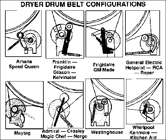

Removed top and front panel, was able to lift drum to get belt on
the belt is still loose around drum, I did not feel the idler arm when putting
on belt. What am I not doing right?
[ATTACH]239[/ATTACH] The belt has to be connected to a spring loaded idler simular to one of these. The admiral crosley 2nd from bottom left is it I think. To access it you must remove the rear panel on some models. On some their is no rear panel.
