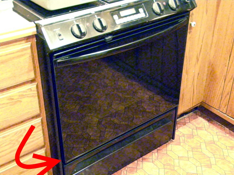

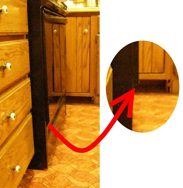

I have an Amana ARDS802E range. Today, I noticed that the door is sticking out where it hinges, and it is not flush with the drawer below it.
Does this look correct? see attached pictures.
If it is somehow messed up, anyone have any ideas how this could happen?
thanks
Looks like your hinge is sprung, possible from something heavier being placed on the door while open. The hinge part number is Part Details - MAYTAG Oven door hinge, left side, part number: R0706010
