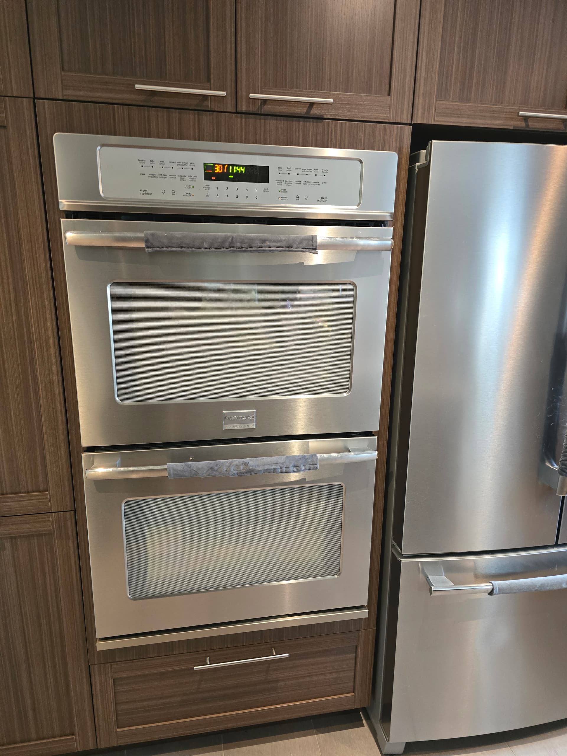

Display flashing 2 times when its on baking, after that, continuing working
Brand: frigidaire
Model Number: CPET3085KF2
Main Symptom: Display flashing 2 times when its on baking, after that, continuing working
Just upper oven, lower oven working fine
What happens & when: no thing
Error Code (if any): no
Parts or tests already tried: no
The display goes off (no lights) and comes back on a couple of times before settling down and working properly?
jeff sr.
Blinking one second and 1 second
After that continue working; just upper oven
Lower working fine
Jeff, you may have a display board that is getting hot and /or failing, Sometimes a solder connection will cause that issue.
Lets hope it is something in the control board and not the display control as the display control is no longer available.
