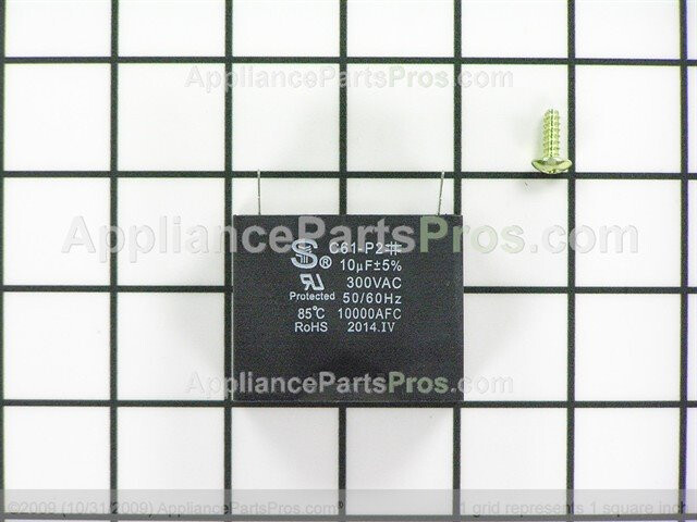

Brand:samsung
**Model Number:**dw80f600uts/aa
Main Symptom:spray arms not spraying
Brand:samsung
If the spray arms are not turning, the wash motor is running and there is plenty of water, the wash motor is probably bad. DD82-01065B Dishwasher Sump And Motor Assembly | Genuine Samsung OEM In Stock Just because the motor runs does not mean it is able to turn the impeller with enough pressure to move the water up to the spray arms.
No, that is a capacitor. There is something in the wash motor that is making the noise. The impeller is either hitting something or it has failed. And there is enough water in the tub? The wash motor is the only thing moving.
