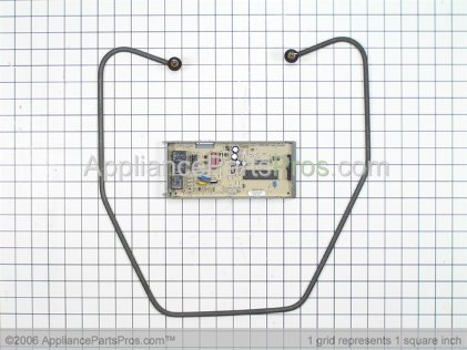

I see the heater element Sears part # 8194200 comes with a control board, same for the appliancepartspro.com part number AP3841139. Trouble is both show the heater element with angled bends in it and the one in my dishwasher is more round. No bends. Is the picture wrong and if I order part AP3841139 will the element be round like the one I have?

AP3841139/8194200 element/control combo is a replacement for the older element that Whirlpool had a major problem with. That is why the control board is also included and the element itself has been changed.
This Whirlpool service pointer will explain and confirm everything for you.
This is from a Whirlpool 8194200 sheet:
[LEFT]— NOTICE —
This is an approved service kit for the parts
you ordered. The heater element and electronic
control MUST be replaced as a set.
Please use ALL the parts contained within[/LEFT]
this kit to make your repair.
And this is the updated instructions sheet for this kit.
The heater element ordered fit just fine. The control board installed no problem. The only thing I might have done would be to replace the platic nuts that secure the heating element. My wife is very happy :slight_smile:
