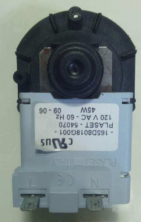

My GE dishwasher is not draining and it is not clogged, I have removed everything from the draining systme and hose. it seems to me that the pump is pot working, how can i make sure that is is the case and where can I buy the pump part number plaset 54070

The model is PDW8280J10SS and I need to know how to make sure that the problem is the pump as it is not draining and it is not clogged, the pump number is plaset 54070

Since you have checked the drain path and it is OK, I would measure the voltage at the drain pump when it should be draining. If you have 120 volts and it is not pumping then I would say that the pump is toast.

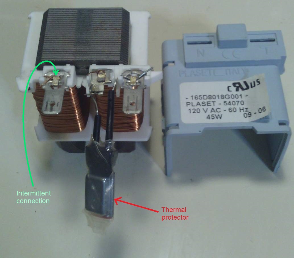

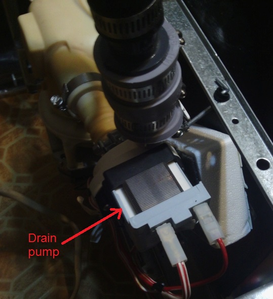

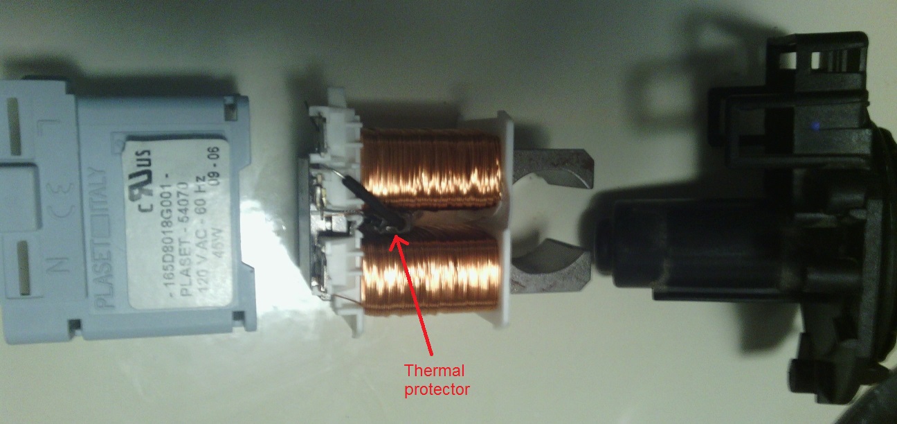

I repaired mine. Here’s a picture:
http://www.burtonsys.com/GE_Profile_dishwasher/IMG_20140804_221817_75pct_annotated.jpg
I concluded that it was the thermal cutoff/protector, so I replaced the thermal protector with one I bought on a big online auction site (5 for $4.18, delivered, “5 pcs Motor thermal cutoff protector thermostat”).
But I must have also inadvertently damaged one of the field winding connections, because it went “open” where it connects to the terminal. So I ended up having to reconnect it to its terminal with a short copper wire splice.
Photo of pump installed:

Pump disassembled:
http://www.burtonsys.com/GE_Profile_dishwasher/IMG_20140804_205608_50pct_annotated.jpg
