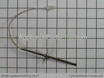

I am getting a F1 code , the first error message was f3 the first time I unplugged and plugged back in and now Im getting F1 error. I got the code to clear off and then it was good over night and now its doing it again and its 3 pm Can you help me with my problem the panel is Black on my stove Thanks
The first thing I would do is check resistance of the oven temperature probe.
[CENTER]The oven temperature probe
[/CENTER]
[LEFT]It suppose to be about 1100 Ohms at the room temperature.
If the reading is wrong then replace the oven temperature probe.
If the reading is correct then replace the Electronic Oven Control (EOC).
The part number for the oven temperature probe is [COLOR=#800080]AP3363354[/COLOR]
The part number for the EOC is [COLOR=#800080]AP3677078[/COLOR]
Gene.[/LEFT]
