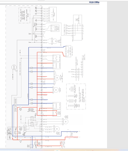

You’ll need a multimeter to properly test the pump. I’m going to post the tech sheet to help guide you through checking and testing the drain pump.
Technical-Reference-Manual-22110313 (1).pdf (9.0 MB)
