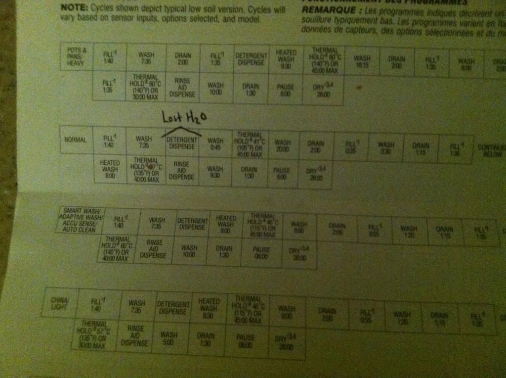

I noticed that during a “normal cycle” setting (the setting we almost use exclusively) the pump sounded strange right after the detergent release and when I opened the door I found the sump empty, bone dry. Now, according to the cycle operation chart for this unit it is not supposed to drain until well into the cycle, so I shouldn’t be losing water to the drain and refilling (or should I?). Basically it will lose water and not refill for the 20min wash cycle. I will find a partially broken up detergent pack sitting on the bottom of the washer 9 times out of 10.
This said, it will work once in a while, this is an intermittent problem. I will more less have to start the cycle and listen for the sound of flowing water, if I don’t hear it I have to fill the sump manually using a pitcher of water, then it works fine.

I have included a pic of the cycle chart with a note of where I am losing water.

We load up the washer with some heavily soiled dishes and start the “normal” cycle.
The unit fills fine, goes through the “prewash” then stops… Then goes into a drain cycle… Then tries to fill and go into a wash cycle with no water in the sump.
So I open the door and bring the sink nozzle over to the unit (one of those nozzles on a hose) and try and manually fill the sump… It would not fill. Run downstairs to the drain hose and water is pouring out as fast as it’s filling.
This said, the drain pump was NOT running, the door was open.
So I know of two things that keep water in when it’s supposed to stay in… The drain hose loops up to near the top of the dishwasher creating a trap, I checked and the hose is sitting up high. The other thing is a small rubber flapper that acts as a check valve for the drain pump. I checked and there is nothing holding it open or wedged in there.
So I canceled the cycle and restarted it with a empty sump… First thing it does is refill and it fills just fine and holds…
