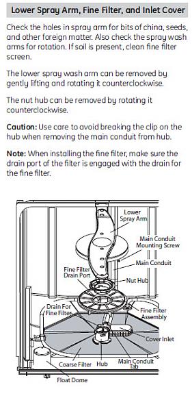

On the bottom there is a “stainless steel” grate, where I am guessing water drains. Does that come off some how, and I need to clean underneath?
You can get into the sump from up top. See attachment.
Check/clean the filter, the sump and the chopper.
Be careful when checking the sump often there is broken glass in it.
You may also want to check your water level. Most units fill to just under the heating element. If you think it may be low add a couple quarts of hot water after each fill during a cycle. Just be careful to not overfill the unit. If the dishes are now clean then fill is probably your problem.
Low fill is often caused by a partial plug of the screen filter on the input side of the water valve. Remove the valve and check/clean the screen. Do not permanently remove the screen. It is there to keep crud out of the valve which could hold it open and cause a flood.

Thanks for the tips. I tried giving it a good cleaning, I did get into the sump area and cleaned out a fair amount of crud, I checked the sprayer arms again and looked for other dirt.
