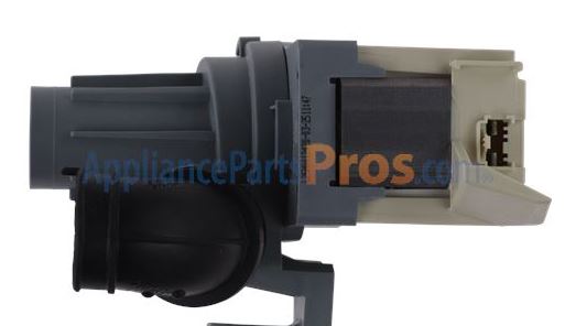

Dishwasher - circulation pump - power connector
Brand: Whirlpool
Model Number: WDF330PAHD0
Main Symptom: The spray arm is not spinning on the top rack. I am replacing the circulation pump.
What happens & when: I am trying to connect power to the replacement circulation pump (W11612326). But I need the right connector socket that fits into the pump. Please see the picture. Where can I get the correct socket connector? What is that connection type called? Thanks
The wiring for this is a part of the wiring harness and this is the correct pump assembly. it should just unplug from the old one and plug into the new one.
https://www.appliancepartspros.com/whirlpool-mp-pmsm-pw-w11612326-ap7193729.html
Correct. It should. But the connector is shattered. I need to replace it.
That being the case, the wiring harness would be the part needed.
https://www.appliancepartspros.com/whirlpool-harns-wire-w11242945-ap6333594.html
I was hoping this wouldn’t be the case. $85 for a 10cent part. But it gets the job done. Thanks!
