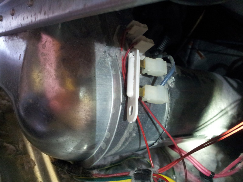

Recently my dryer stopped generating heat when drying clothes. All fuses are fine on the main circuit board, so I suspect the thermal fuse on the dryer itself has probably blown. We haven’t vacuumed out any lint build up over the years so it’s the part that seems most likely to have failed. I’m trying to perform a continuity test on the fuse, but I can’t seem to disconnect the fuse from the leads no matter how hard I tug on them. The leads use some sort of connector so I’m wondering if they’re “locked” onto the thermal fuse terminals?
I’ve attached a picture of the fuse with leads connected. Can anybody advise how to disconnect these leads? It used to be so simple …

I cannot tell if the connector is the lockable type or not from the picture.
Hopefully someone else knows.
In any case it probably will not matter.
If this is the thermal fuse from the blower assembly then it would kill power to the motor.
To kill power to just the heating coil a thermal cut-off (fuse) is used. It is item 47 in the Bulkhead Parts section.

About getting those wires off. Just use a flat tip screwdriver. Slide the tip between the thermal fuse and connector and twist it and it should pop off. But if your dryer still tumbles then that is not the problem.
