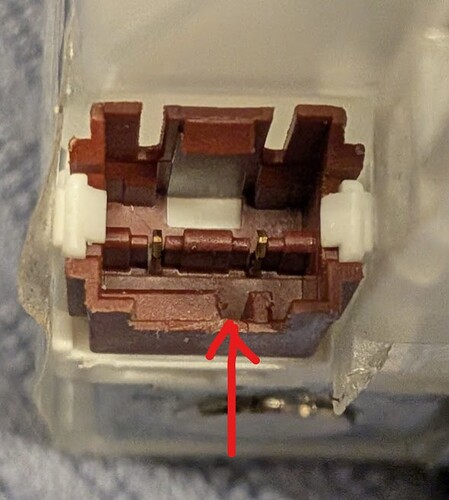

Detergent Dispensor Solenoid Connector on Bosch SHE3ARF5UC/21
Brand:Bosch
**Model Number:**SHE3ARF5UC/21 SN FD950700373
Main Symptom: Detergent Dispensor Solenoid Connector
What happens & when: Replacemnt Part Does Not Fit
Error Code (if any): No
Parts or tests already tried: 12008380 or 00645208
Black connector below is my original solenoid connector receptacle.

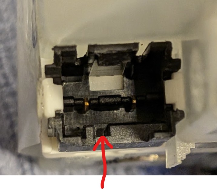

Replacement (not from appliance Parts)
My question:
Will the part provided by Appliance Parts fit my Dishwashers solenoid connector?
If yes, I will order one immediately.
No? What now?
Thanks,
Howard
OEM is always the best choice, and I’m about 95% confident this part will be plug-and-play. That said, we can’t get a clear enough view of the connector in the photos to say with 100% certainty, and we’re not in the warehouse where we can physically compare the new part to your existing one.
If you decide to order it and find that the connector doesn’t match, please don’t try to install it. Just return it in its original condition for a refund.
