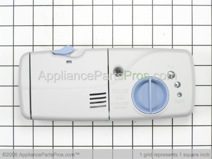

Our dishwasher’s detergent door will not open at all during the cycle. Any idea what might be causing this/how to fix it? Thank you.

Remove the inner door panel.
continuityCheck the wax motor (the brown device with two terminals on the right side) in the dispenser for .
[CENTER]The dispenser.
[/CENTER]
[LEFT]Replace the dispenser assembly if the circuit is open.
Replace the control board if the circuit is closed.
The part number for the dispenser assembly is [COLOR=#800080]AP403926[/COLOR]
The part number for the control board is [COLOR=#0066cc]AP3158622[/COLOR]
