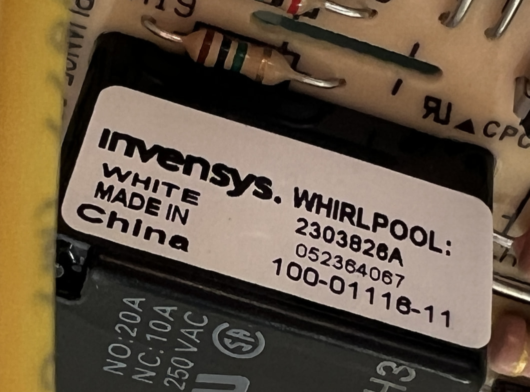

  • the ADC2000 part number (2303824, 2303825, etc.),

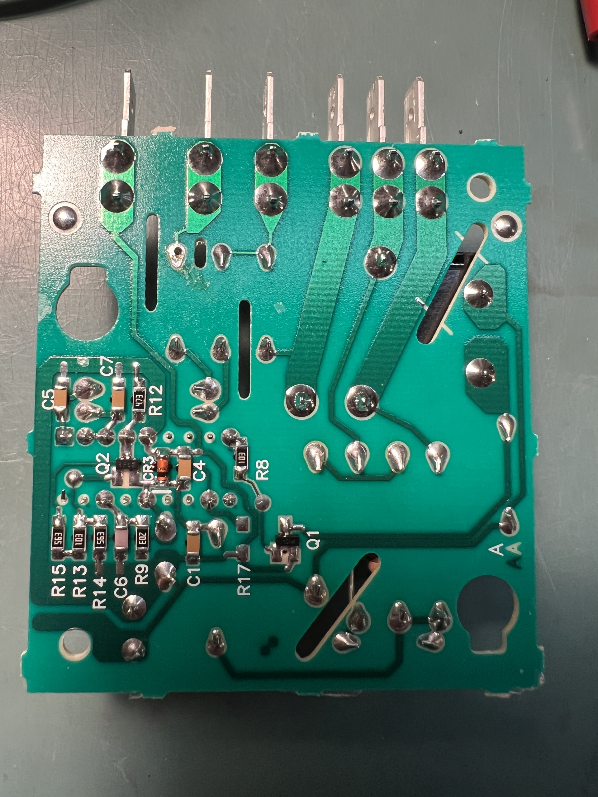

Yes compressor is off while these short pulses occur. No ice buildup. This is the text I sent to a few technicians. I got one response, stating it was out of his league. "I have a 2005 KitchenAid KTRP19KRWH00 refrigerator equipped with an Invensys ADC2000 Adaptive Defrost Controller.
Over the past few months I’ve noticed frequent relay clicking. Using a Home Assistant power monitor (Ikea Grillplats plug power into which the fridge is connected), I’ve observed that instead of a single normal defrost cycle, the ADC often energizes the defrost heater for two short 20–30 second pulses separated by a brief pause before returning to cooling. I’m wondering whether this behaviour could indicate a failing ADC2000 board, a problem with its adaptive control logic or stored parameters, or some other known issue with these controllers.
The refrigerator otherwise cools normally, and examining the evaporator coil shows a uniform ‘normal’ frost pattern, with no ice buildup.
I have also cleaned the condenser coils (it was very dusty); so everything is clean, but this odd behaviour remains."

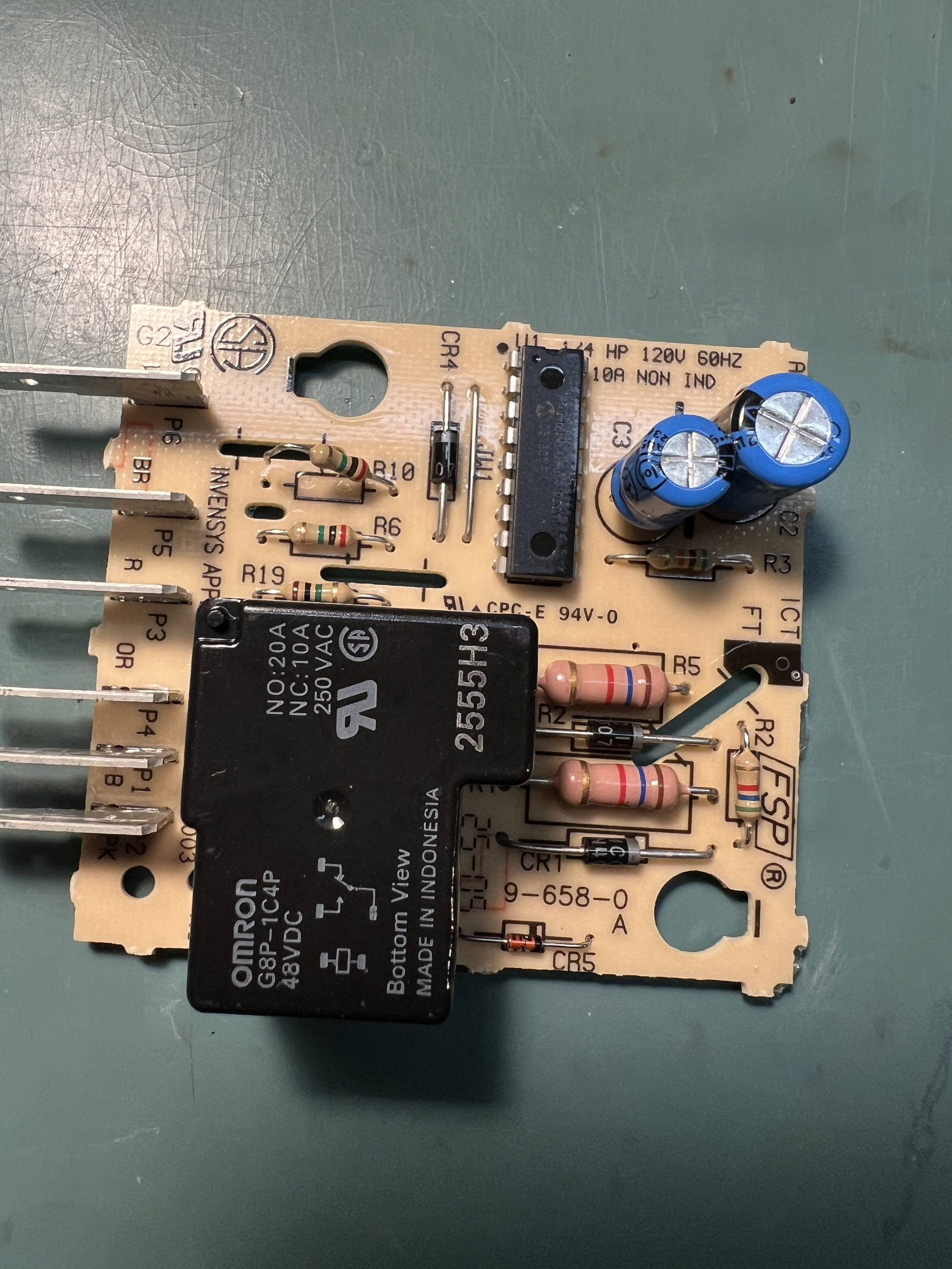

This feels more like the controller making bad decision than a relay struggling to stay closed.
I’m tempted to disconnect R10 as the next step, to disable the adaptive behaviour.
Forced defrost seems to work fine. I’m confident that the power goes into the heater, based on the thermal lag/temperature monitor I have in the freezer compartment.
Almost definitely a board/relay issue
Could it be the low voltage rail to the micro sagging upon relay activation, as a result of degraded bulk capacitor on the ADC?
So I have two options so far: 1) pull R10 to see if that helps; I believe the defrost should then occur after 10 hours of compressor run time, or 2) replace the ADC2000, about $300CAD with tax. Fridge currently burns about 2kWh/day, about 30% higher than the advertised power consumption.
Yeah I’d start with pulling that r10 and see if it makes a difference
Also, have you actually seen repeated 20–30 second heater pulses disappear after lifting R10, or is this more of a diagnostic step to determine whether the adaptive algorithm is involved?
There were 105 short defrost events yesterday; this can’t be good the for the relay. I lifted one side of R10, and got two more short pulses since, so this suggests that nothing has changed and that these pulses are not caused by the adaptive algorithm.
The controller was observed to be a Microchip Tech P/N PIC16C54C.
I really suspect the relay/control board
So am I right in thinking that these short defrost pulses are not normal under any circumstances?
Exactly they are very indicative of something electronically wrong somewhere in the control sytem
