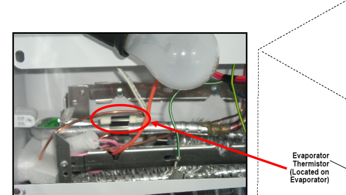

This thermistor that is mounted on the evaporator is what going to sense when to defrost or cool!
I guess you replace this? Defrost Over temperature Thermostat WR50X10068.This
Thermistor WR55X10025 This Defrost Heater WR51X10101
I have replaced that thermistor along with the second one in the freezer and the one connected to the damper in the refrig. Could I have a faulty one?
