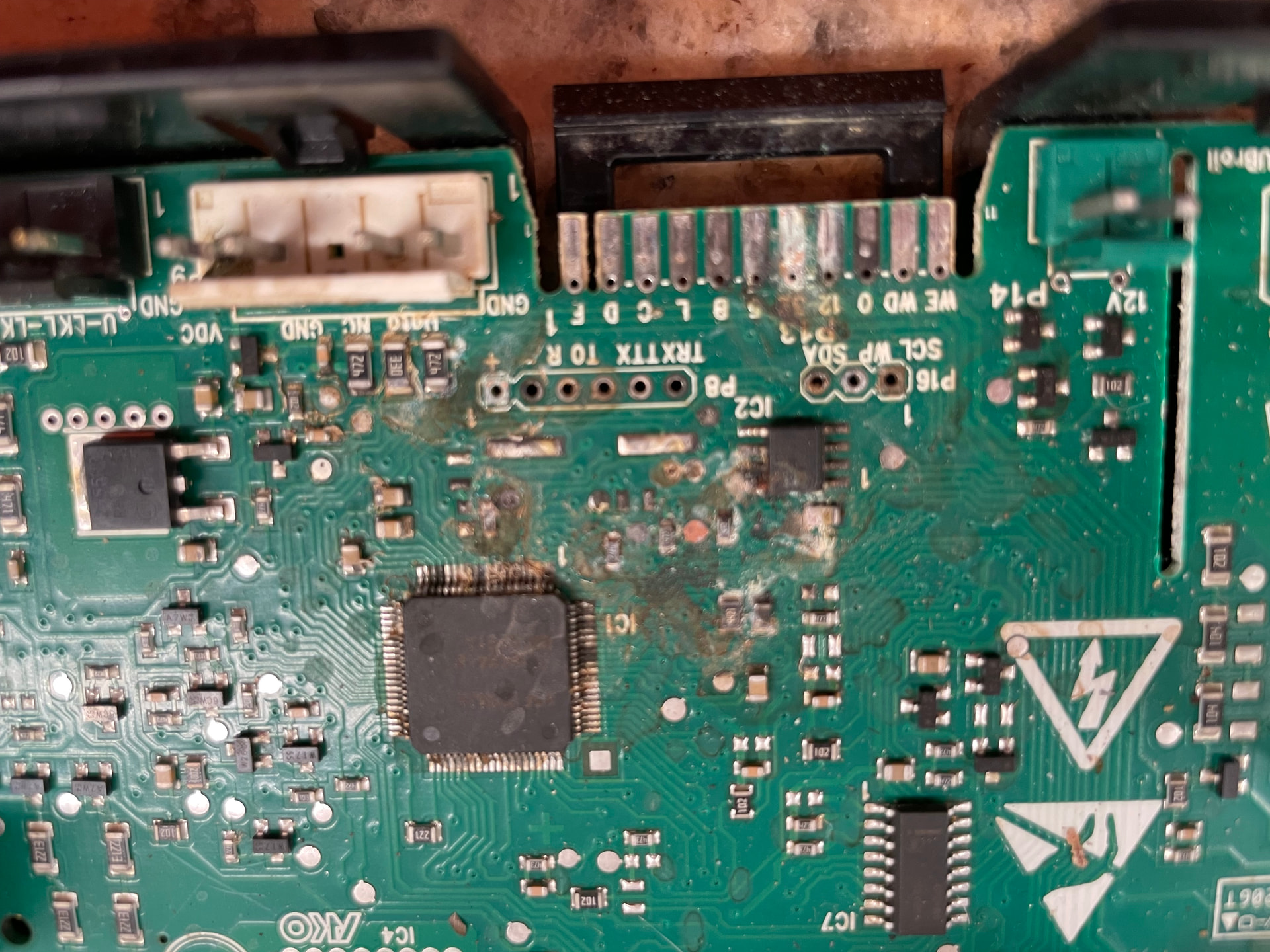

I have a jennaire elect stove oven (JES1750ESO) which display went black. I traded out the display (#29) and didn’t change it. Wondering if it’s likely 16 or 21 on specs?
- Derek
Ensure you have all the connections in tight and nothing loose. If it is not a loose connection or #29 it would likely be #21.
https://www.appliancepartspros.com/whirlpool-cntrl-elec-w10803488-ap5982829.html

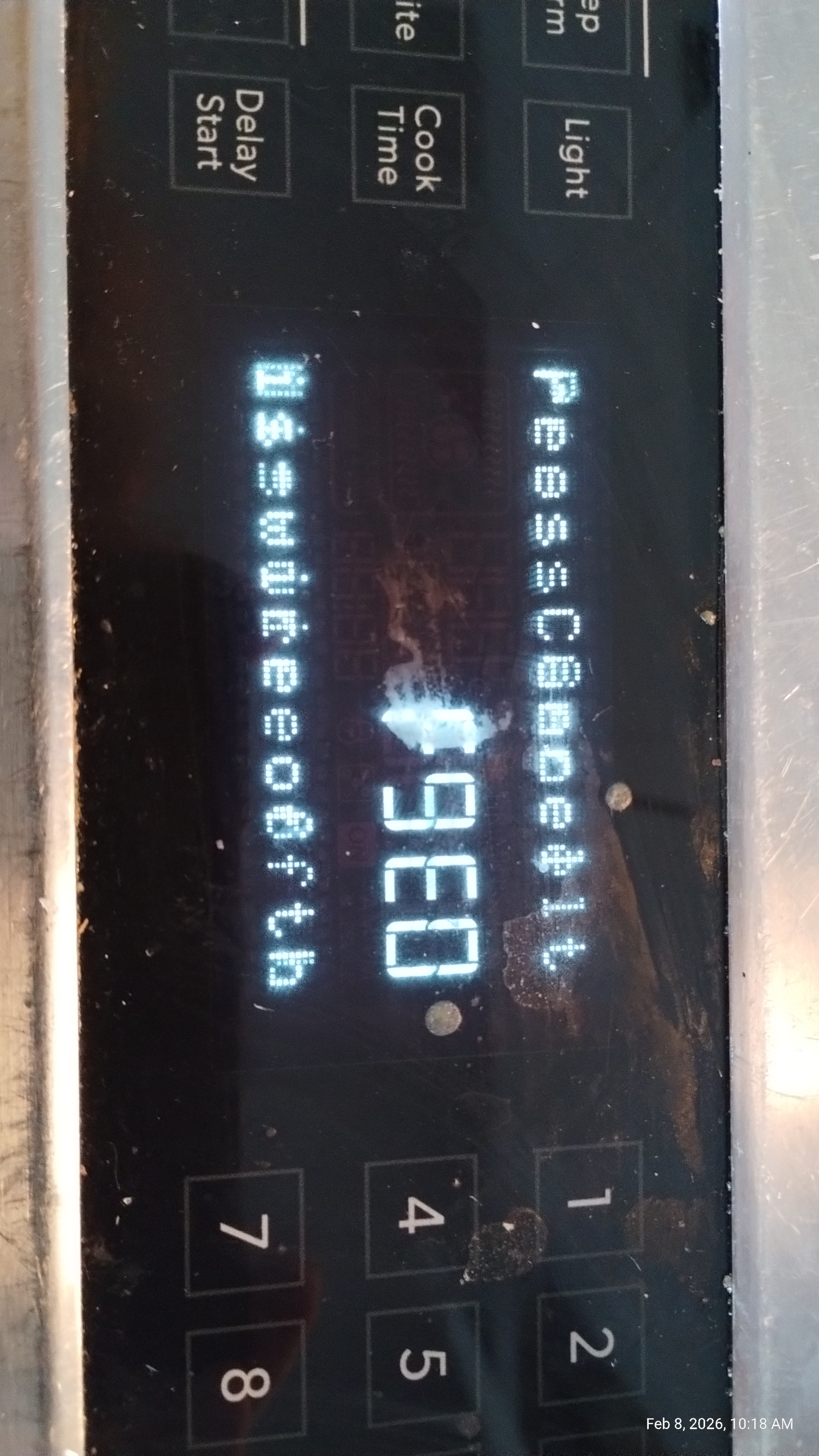

Seemed to have been working but now I’m getting this message
Miswired? All plugs went back as they had come out. The ribbon wired was a bit burnt at the connection but like I said it worked.
Any thoughts would be appreciated!
Any loose or damaged connections should be repaired or replaced to prevent future damage and failures.
